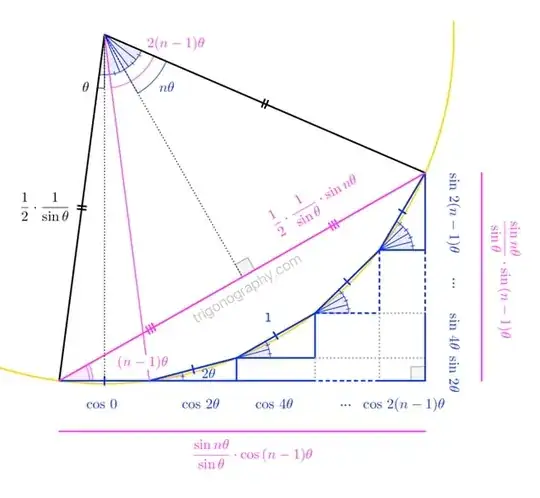

Here's a trigonograph for $a = 0$ and $d = 2\theta$:

  • I've understood where the $\frac{1}{2}\frac{1}{\sin\theta}\sin n\theta$ and $\cos2(n-1)\theta$come from but I do not see visually from the diagram why the product of the two gives the answer - is the product area? Please could you explain why the product of the two on the diagram gives the answer. – onepound Feb 05 '20 at 14:45
    @onepound: The big right triangle (with "trigonography.com" along its hypotenuse) has a hypotenuse length of $\sin n\theta/\sin\theta$. The triangle's acute angle on the left is an inscribed angle in the circular arc, so its measure is half the corresponding central angle, $2(n-1)\theta$. Thus, the horizontal and vertical legs of that right triangle are, respectively, $\text{(hypotenuse)}\cdot \cos(n-1)\theta$ and $\text{(hypotenuse)}\cdot \sin(n-1)\theta$. – Blue Feb 05 '20 at 15:01
  • I know I am asking this very late but where does the factor of "1/2" come from in the length of the hypoteneuse of the triangle with angle "θ". Shouldn't it just be "1/sinθ" (as sin θ = P/H, so H = P/sin θ and P is just cos 0 which is 1)? Also, I don't think it is related to the area in anyway because we are unware of the base of that triangle. – Bhavya Jain Jul 25 '23 at 18:32
  • @BhavyaJain: "where does the factor of "1/2" come from in the length of the hypoteneuse of the triangle with angle "$\theta$". Shouldn't it just be "$1/\sin\theta$" (as $\sin\theta=P/H$, so $H = P/\sin\theta$ and $P$ is just $\cos 0$ which is $1$)?" ... I admit that the diagram could be clearer about this, but you've almost answered your own question: Just note that $P$ here is in fact only half of the $\cos 0$ segment. ... Cheers! :) – Blue Jul 25 '23 at 18:58
    I am honestly embarrased of myself for not paying a closer look to the diagram itself. Still I want to thank you so much for such a beautiful geometric representation and the fact that you took your time out to respond so quickly to my comment on such an old post. Thanks a lot!! – Bhavya Jain Jul 25 '23 at 19:18
    @GSmith: "Did you create that image in the trigonography site?" Yep. I'm the Trigonographer. ... "Nice work!!!" Thanks!!! :) :) :) – Blue Jun 04 '24 at 10:02
    @Blue I figured that out from this pdf Almost Everything you Need to Know About Trig. Anyways, great answer! – GSmith Jun 04 '24 at 10:17
