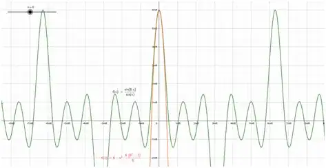

  • To me it looks like $n-\frac{x^2n(n^2-1)}{6}$ is a good approximation function of $\frac{\sin{nx}}{\sin{x}}$ for small values of $x$ (or for small values of $x+ z\pi$, $z\in\mathbb{Z}$, it depends on $n$, because the second one is periodic with period multiple of $\pi$).
 (click for the image image)
