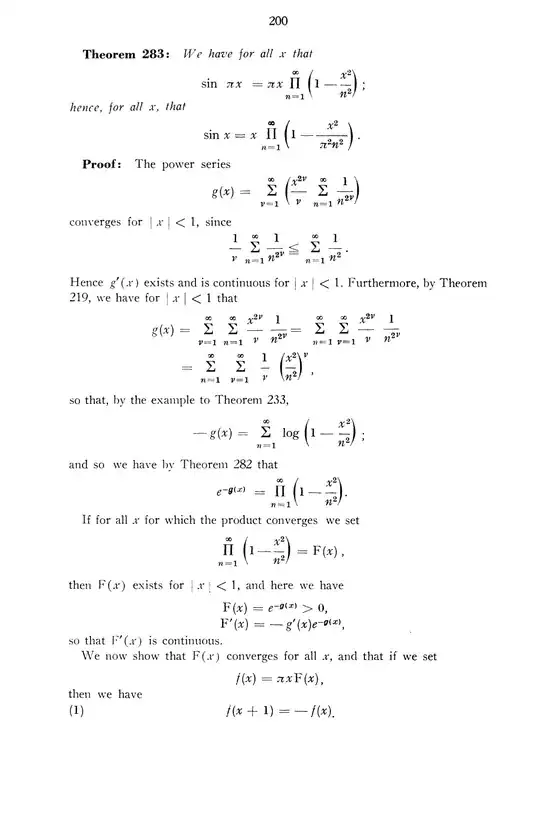

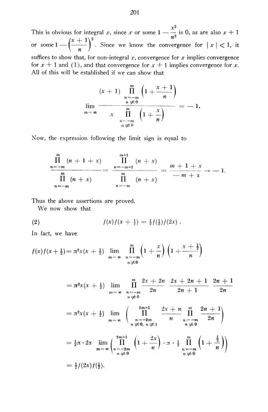

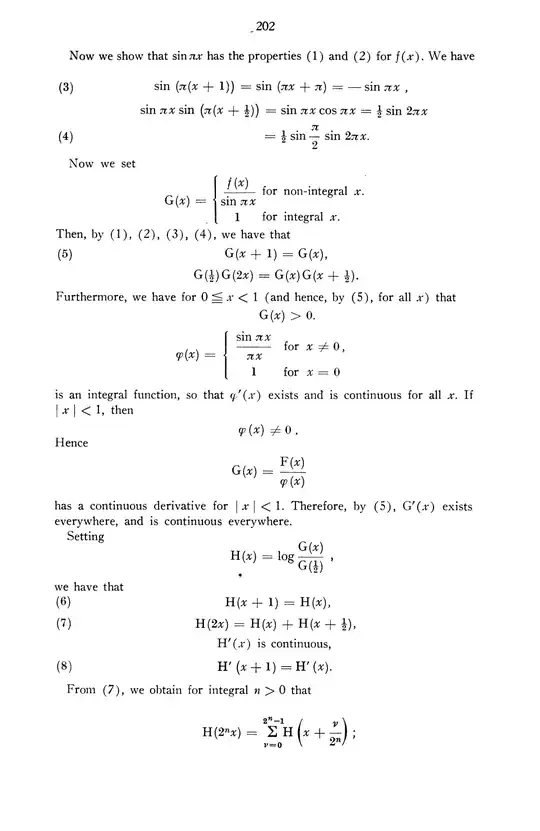

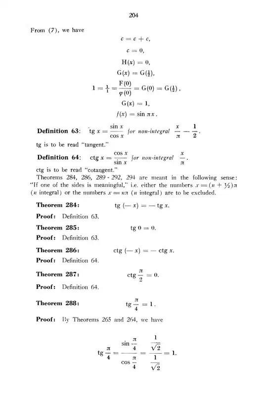

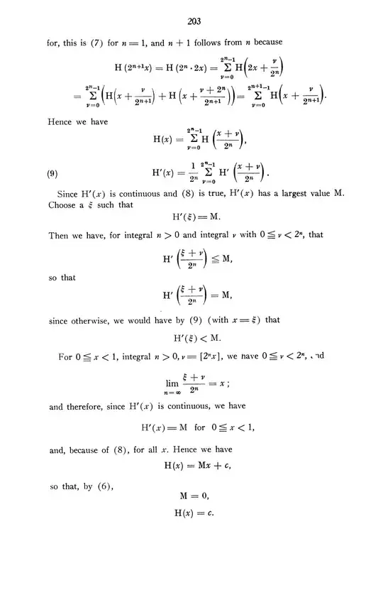

Courtesy of Edmund Landau, from his Differential and Integral Calculus.
enter image description here enter image description here enter image description here enter image description here

  • I don't have that book, and which part of a usual book on Mathematical Analysis could I find the proof in,like Zorich's 《Mathematical Analysis》 or ГригорийМихайлович Фихтенгольц‘s 《Calculus course》. I mean what topic it is included in? – Miao Oct 17 '12 at 23:36
  • I need theorem 233 – PPP Sep 18 '13 at 04:01
  • @LucasZanella You can google the book, it is called "Differential and Integral Calculus" by Edmund Landau. – Pedro Sep 18 '13 at 04:19
