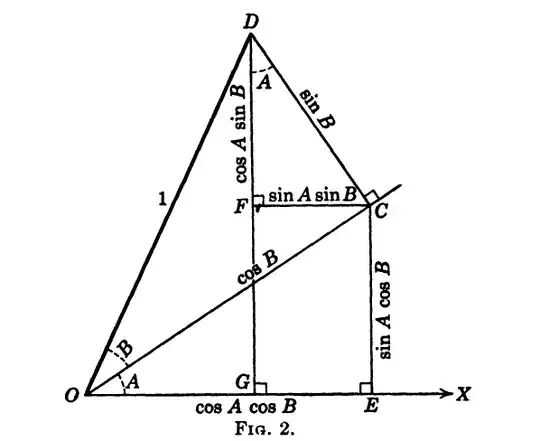

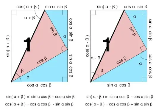

Here are my favorite diagrams:
Proof Without Words: Angle Sum and Difference for Sine and Cosine
As given, the diagrams put certain restrictions on the angles involved: neither angle, nor their sum, can be larger than 90 degrees; and neither angle, nor their difference, can be negative. The diagrams can be adjusted, however, to push beyond these limits. (See, for instance, this answer.)
Here's a bonus mnemonic cheer (which probably isn't as exciting to read as to hear):
Sine, Cosine, Sign, Cosine, Sine!
Cosine, Cosine, Co-Sign, Sine, Sine!
The first line encapsulates the sine formulas; the second, cosine. Just drop the angles in (in order $\alpha$, $\beta$, $\alpha$, $\beta$ in each line), and know that "Sign" means to use the same sign as in the compound argument ("+" for angle sum, "-" for angle difference), while "Co-Sign" means to use the opposite sign.

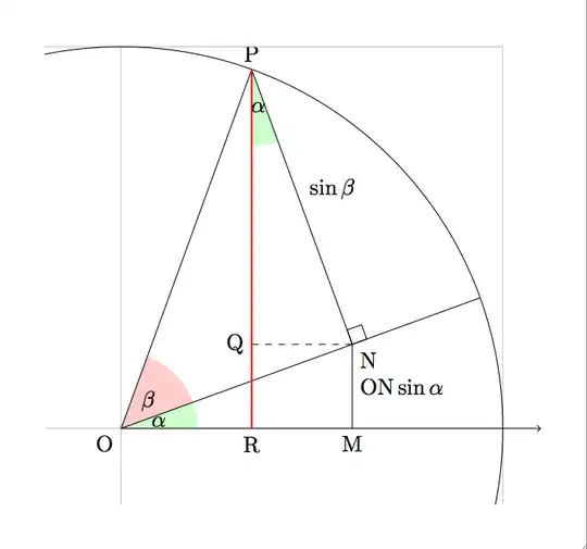

Though the standard high-school derivations are not the most useful way to remember it in the long run, here's another one which I like because you can "see" it directly without much algebra.
Angle sum formulae
Let P be the point on the unit circle got by rotating (1,0) by angle α+β. Drop a perpendicular N to the α-rotated line, and R to the x-axis. So from the right triangle ONP, you see ON = cos β. You can see that the angle RPN is α too: it's the complement of ∠PNQ, and so is ∠QNO = α. Now,
$\sin(\alpha + \beta) = \mbox{PR} = \mbox{PQ} + \mbox{QR} = \sin(\beta)\cos(\alpha) + \cos(\beta)\sin(\alpha)$, and
$\cos(\alpha + \beta) = \mbox{OR} = \mbox{OM} - \mbox{RM} = \cos(\beta)\cos(\alpha) - \sin(\beta)\sin(\alpha)$.
ShreevatsaR
  • 42,279
  • with program did you draw this diagram? – seeker Jul 13 '14 at 17:33
    @Assad: If I remember correctly, I used TikZ, and this was in fact my first time using TikZ. I wish I had kept the source code of this figure; I haven't used TikZ much since then, and I'd have to re-learn it if I wanted to draw this again from scratch. :-) But it couldn't have been too hard, because I did learn enough to draw this. – ShreevatsaR Jul 13 '14 at 17:45
    This is the best answer because it's the simplest (not using imaginary numbers) and has the best visual. – user766353 May 16 '18 at 03:12

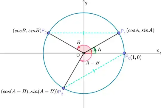

Consider a unit circle with $O$ as the centre. Let $P_{1}$, $P_2$ and $P_{3}$ be points on the circle making angles $A$, $B$ and $A−B$, respectively, with the positive direction of the X-axis. sum&diff.identity We know that if two chords subtend equal angle at the centre, then the chords are equal and chords $P_{3}P_{0}$ and $P_1P_2$ subtend equal angles at $O$. Therefore, $\overline{P_{3}P_{0}}=\overline{P_1P_2}$. By distance formula, the distance between the points $P_{0}(1,0)$ and $P_{3}(\cos(A−B),\sin(A−B))$ is $$P_{3}P_{0}=\sqrt{\left(\cos \left( A-B \right) - 1\right) ^{2} + \left(\sin \left( A-B \right) - 0\right) ^{2}}$$ Similarly, the distance between the points $P_{1}(\cos A,\sin A)$ and $P_{2}(\cos B,\sin B)$ is $$P_1P_2= \sqrt{\left( \cos B-\cos A\right) ^{2}+\left( \sin B - \sin A \right) ^{2}}$$
On squaring both sides, we get
$$ \begin{array}{ll} \Rightarrow & \left\{\cos (A-B)-\left.1\right|^{2}+\sin ^{2}(A-B)=(\cos B-\cos A)^{2}+(\sin B-\sin A)^{2}\right. \\ \Rightarrow & \cos ^{2}(A-B)-2 \cos (A-B)+1+\sin ^{2}(A-B)=\cos ^{2} B+\cos ^{2} A-2 \cos A \cos B \\ & +\sin ^{2} B+\sin ^{2} A-2 \sin A \sin B \\ \Rightarrow & 2-2 \cos (A-B)=2-2 \cos A \cos B-2 \sin A \sin B \\ \Rightarrow & \cos (A-B)=\cos A \cos B+\sin A \sin B \\ \text { Hence, } & \cos (A-B)=\cos A \cos B+\sin A \sin B \end{array} $$
Wolgwang
  • 1,563

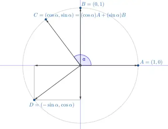

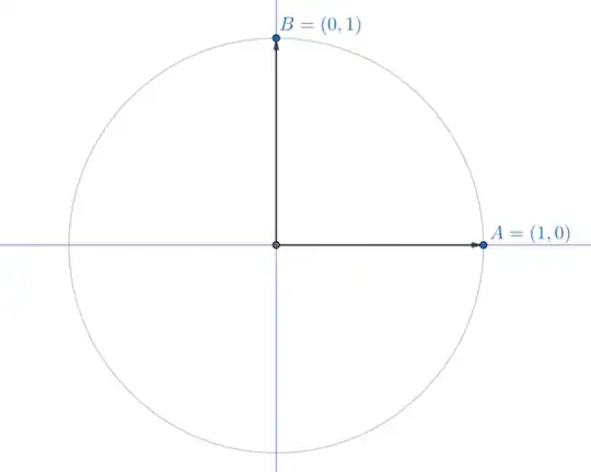

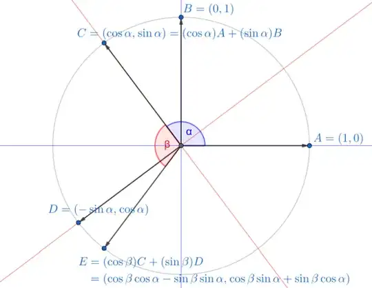

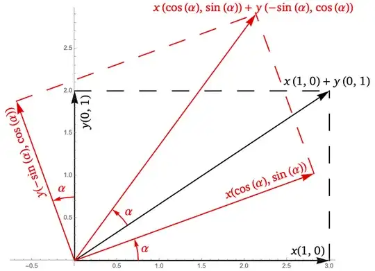

The following is (essentially) a graphical version of an earlier answer, relying on some simple vector operations in two dimensions but without explicitly invoking matrices.
The argument is summarized in the following diagram.
This is meant to be a proof without words, but for clarity, I'll build up to the conclusion step by step below.

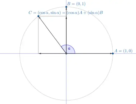

First, let's just consider the unit circle in the usual Cartesian plane. Here it is, along with the $x$ and $y$ axes and unit vectors from the origin to the two points $(1,0)$ and $(0,1).$ We use $A=(1,0)$ and $B=(0,1)$ to denote the position vectors of these two points.
Next we add a point at an angle $\alpha$ counterclockwise around the circle from the point $A=(1,0).$ According to the unit circle interpretation of the sine and cosine, the coordinates of this point, and hence the coordinates of its position vector, are $C = (\cos\alpha, \sin\alpha).$
But as illustrated in by the vector sum figure, this is equivalent to saying that $C$ is a linear combination of the two vectors $A=(1,0)$ and $B=(0,1),$
$$ C = (\cos\alpha) A + (\sin\alpha) B. $$
The equation above is a coordinate-free way of constructing a unit position vector rotated an angle $\theta$ counterclockwise from a given unit vector: find a unit vector at a right angle counterclockwise from the given vector, and the rotated vector is $\cos\theta$ of the given vector combined with $\sin\theta$ of the right-angle vector.

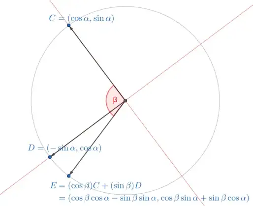

Now that we have the unit vector $C$, we construct a unit vector $D$ at a right angle clockwise from $C$:
The vector sum figure, rotated $90$ degrees from the figure in the previous diagram, shows that the $x$ coordinate of $D$ is the opposite of the $y$ coordinates of $C$ while the $y$ coordinate of $D$ is simply the $x$ coordinates of $C.$ If this is not obvious enough, you can verify it for a vector $C$ in each of the four quadrants.
Now we construct a unit vector $E$ at an angle $\beta$ counterclockwise from $C.$
We construct this vector as a linear combination of the given vector $C$ and the vector $D$ at a right angle counterclockwise from $C,$ that is,
$$ E = (\cos\beta) C + (\sin\beta) D. $$
Finally, we multiply the coordinates of $C$ by the scalar $\cos\beta$, multiply the coordinates of $D$ by the scalar $\sin\beta$, and add the resulting vectors coordinatewise to get the coordinates of $E$:
$$ E = (\cos\beta\cos\alpha - \sin\beta\sin\alpha, \cos\beta\sin\alpha + \sin\beta\cos\alpha). $$
But $E$ is a vector at an angle $\alpha + \beta$ counterclockwise from $A=(1,0),$ and therefore its coordinates give two trigonometric functions of $\alpha + \beta,$
\begin{align} \cos(\alpha + \beta) &= \cos\beta\cos\alpha - \sin\beta\sin\alpha, \\ \sin(\alpha + \beta) &= \cos\beta\sin\alpha + \sin\beta\cos\alpha. \end{align}
Simple rearrangement within the terms gets us the usual formulas for these functions.

I just recently came up with this, so I thought I'd share. By utilizing the complex plane, I can easily derive the double angle formulas in my head, and quickly develop the sum and difference formulas on paper. You need only understand that multiplying by a complex number amounts to scaling and rotation in the plane. enter image description here
Pedro
  • 125,149
  • 19
  • 236
  • 403
Let $\alpha, \beta, \theta \in \mathbb{R}.$ Consider vectors $\vec{P} = (\cos(\alpha), \sin(\alpha)), \vec{Q} = (\cos(\beta), \sin(\beta) ),$ and their rotated versions $\vec{P'} = (\cos(\alpha + \theta), \sin(\alpha + \theta) ), \vec{Q'} = (\cos(\beta + \theta), \sin(\beta + \theta) ).$
Rotations preserve distances, so $PQ = P'Q',$ ie $(\cos(\alpha) - \cos(\beta)) ^2 + (\sin(\alpha) - \sin(\beta) ) ^2$ $= (\cos(\alpha + \theta) - \cos(\beta + \theta) ) ^2 + (\sin(\alpha + \theta) - \sin(\beta + \theta) ) ^2 ,$ ie ${\color{green}{\cos(\alpha) \cos(\beta) + \sin(\alpha) \sin(\beta) = \cos(\alpha + \theta) \cos(\beta + \theta) + \sin(\alpha + \theta) \sin(\beta + \theta)}}.$
This holds for all values of $\alpha, \beta, \theta.$
Setting $\alpha = 0,$ $\cos(\beta) = \cos(\theta) \cos(\beta + \theta) + \sin(\theta) \sin(\theta + \beta).$ Further setting $\lbrace \beta = A+B, \theta = (-B) \rbrace$ gives $\cos(A+B) = \cos(A) \cos(B) - \sin(A) \sin(B).$
Similarly setting $\alpha = \frac{\pi}{2}$ gives $\sin(\beta) = -\sin(\theta) \cos(\beta + \theta) + \cos(\theta) \sin(\beta + \theta),$ and further setting ${ \lbrace \beta = A + B, \theta = (-B) \rbrace }$ gives ${ \sin(A+B) = \sin(A) \cos(B) + \cos(A) \sin(B) }.$
I will provide another proof for $\sin{(x+y)}$ that is possible because, although traditionally presented in textbooks as a consequence of the angle sum identity $\sin{(x+y)}$, the double-angle formula for the sine, $\sin{(2x)}=2\sin{(x)}\cos{(x)}$, can be derived independently of it (see the wonderful proof without words of "Start wearing purple"). Then, as Blue has pointed out, the fact that supplementary angles have the same sine is an easy consequence of the double-angle formula.
The following proof is valid for $0\le\alpha\le\pi$, $0\le\beta\le\dfrac{\pi}{2}$, $0\le\alpha+\beta\le\pi$.
Theorem. The sum identity for sine states that
$$\sin{(\alpha+\beta)}=\sin{(\alpha)}\cos{(\beta)}+\cos{(\alpha)}\sin{(\beta)}.\tag{1}$$
Proof. Suppose $\triangle{ABC}$ is a triangle with sides $\overline{BC}=a$, $\overline{AC}=b$ and $\overline{AB}=c$. Let $\angle{BAC}=\alpha$, $\angle{CBA}=\beta$ and $\angle{ACB}=\gamma$. Recalling that the area of a triangle can be expressed as $\Delta=\frac12bc\sin{(\alpha)}$ and substituting from the cosine rule on the right-hand side of $(1)$, we have
$$\begin{aligned} \sin{(\alpha)}\cos{(\beta)}+\cos{(\alpha)}\sin{(\beta)} &= \left(\frac{2\Delta}{bc}\right)\cos{(\beta)}+\left(\frac{2\Delta}{ac}\right)\cos{(\alpha)}\\&=\frac{2\Delta}{c}\left(\frac{\cos{(\beta)}}{b}+\frac{\cos{(\alpha)}}{a}\right)\\ &=\frac{2\Delta}{c}\left(\frac{a^2+c^2-b^2}{2abc}+\frac{b^2+c^2-a^2}{2abc}\right)\\&=\frac{2\Delta}{ab}\\&=\sin{(\gamma)}\\&=\sin{(\pi-(\alpha+\beta))}\\&=\sin{2\left(\frac{\pi}{2}-\frac{\alpha+\beta}{2}\right)}\\&=2\color{red}{\sin{\left(\frac{\pi}{2}-\frac{\alpha+\beta}{2}\right)}}\color{blue}{\cos{\left(\frac{\pi}{2}-\frac{\alpha+\beta}{2}\right)}}\\&=2\color{red}{\cos{\left(\frac{\alpha+\beta}{2}\right)}}\color{blue}{\sin{\left(\frac{\alpha+\beta}{2}\right)}}\\&= \sin{\left(\alpha+\beta\right)}.\end{aligned}$$

From a good old book, written by Professors at USNA ( Plane and spherical trigonometry by Lyman Kells et al.)
