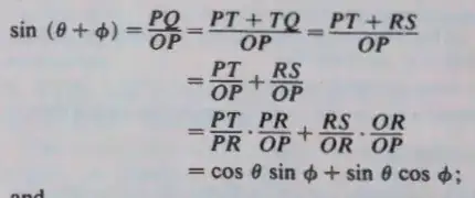

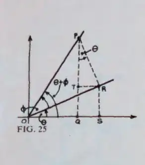

I am currently learning about the Trig addition formula. The book I am reading has a proof for it. The proof is attached here:
enter image description hereenter image description here
However, I have a question about it. What if the values of theta and phi were greater than 90 degrees, or basically so great that you can't fit them in a right triangle. Since the proof relies on right triangles, would it still be legitimate in such a scenario? Can someone please explain? Don't give me another proof, simply explain if the proof in the book is legitimate for the values of theta and phi were greater than 90 degrees. And if not, then give me another proof.

You are convinced with the picture about the case where $$ \theta +\phi < \pi/2 $$ Then in case of $$ \theta +\phi > \pi/2$$ we have $$ \pi - (\theta +\phi) < \pi/2$$
$$ \sin(\theta +\phi)=\sin (\pi -(\theta +\phi)) = \sin ((\pi /2- \theta)+(\pi /2- \phi))$$
Note that the new angles $$(\pi /2- \theta) \text { and }(\pi /2-\phi)$$ fit the picture and you get the desired result.

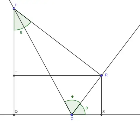

If all you want to do is to handle the case where $90^\circ < \theta + \phi < 180^\circ,$ then the figure looks like this:
You need to know how $\sin(\theta + \phi)$ is defined when $\theta + \phi > 90^\circ.$ Once you know the definition, it will be clear that $\sin(\theta + \phi) = \frac{PQ}{OP},$ and the rest of the proof proceeds as before.
