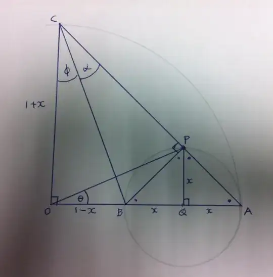

In answer to the first question, I have been trying to upload a picture but without success, so I'll have to describe it instead.
  1. Draw an isosceles right-angled triangle OAC with A on the x axis and C on the y axis, and O as the origin.
  2. Choose a point P on the line AC, with Q as the foot of the perpendicular from P onto OA
  3. Let B be the point on OA so that Q is the midpoint of BA
  4. Let OQ be 1 unit long, and PQ be of length $x$, in which case BQ and AQ also have this length
  5. We now have $\tan POQ=x$ and $\tan OCB=\frac{1-x}{1+x}$
  6. It simply remains to show that angle BCP = angle POQ, which is easy enough since triangle CPB is right angled and CP has length $\sqrt2$
I hope this is clear enough

  • For this to be fully valid, $P$ has to be at least as close to $A$ and $P$ is to $C$. If the opposite inequality holds, then $\tan(\angle OCB)=\dfrac{x-1}{x+1}$ $\ne\dfrac{1-x}{1+x}$. ${}\qquad{}$ – Michael Hardy Jun 15 '15 at 12:28
  • Corollary: $C,P,B,O$ are concyclic. The center of the circle on which all four of these points lie is the midpoint between $B$ and $C$. ${}\qquad{}$ – Michael Hardy Jun 15 '15 at 12:30
  • Yes the diagram shows when $0 \le \arctan x \le \frac {\pi}{4}$.. When the diagram is drawn as you are suggesting, so that $\frac {\pi}{4} \le\arctan x<\frac {\pi}{2}$, the identity becomes $$\arctan x-\arctan \frac {x-1}{x+1}=\frac {\pi}{4}$$ which is equivalent to the original – David Quinn Jun 15 '15 at 12:48
  • Can this argument be adapted to make it obvious that $\arctan x$ and $\arctan\dfrac{1-x}{1+x}$ play entirely symmetrical roles? – Michael Hardy Jun 15 '15 at 12:52
  • do you mean re-label the diagram? Let $OC = x$, $OB=1$, with $PQ=AQ=BQ =\frac{x-1}{2}$, and carry on as before. – David Quinn Jun 15 '15 at 13:00
  • But the diagram is still asymmetric. – Michael Hardy Jun 15 '15 at 13:01
  • But why would the diagram have to be symmetric? It would only be so if $\arctan x = \frac {\pi}{4}$ – David Quinn Jun 15 '15 at 13:29
  • I didn't mean geometrically symmetric; I meant logically symmetric. I.e. the roles played by $x$ and $\dfrac{1-x}{1+x}$ would be entirely interchangeable. ${}\qquad{}$ – Michael Hardy Jun 15 '15 at 13:31
  • But they are interchangeable! try labelling PQ as 1-x, BQ as 1+x, etc. and you get OB = 2x and OC = 2. The same result follows. For bigger angles, label PQ as x+1, OQ as x-1, and you get OB = 2 and OC = 2x – David Quinn Jun 15 '15 at 13:40
    @DavidQuinn I've uploaded your beautifully drawn diagram. Feel free to edit your post accordingly. – Simon S Jun 15 '15 at 14:37
    @SimonS: thank you for doing that! – David Quinn Jun 15 '15 at 14:52
  • @DavidQuinn : They are interchangeable in the sense that you can relabel them in that way. But look at the two angles you've labeled $\alpha$ and $\varphi$. Both of them are acute angles in a right triangle, and those two triangles share the hypotenuse in common. But you've extended side adjacent to $\alpha$ beyond the vertex of the right angle, and drawn some other things beyond that point, whereas with $\varphi$ you haven't. ${}\qquad{}$ – Michael Hardy Jun 15 '15 at 15:13
  • I don't quite understand what you mean, so I'm going to upload a new picture in due course – David Quinn Jun 15 '15 at 15:35
  • @DavidQuinn : To be more explicit: $BCP$ is a right triangle. The leg of that triangle that is adjacent to $\alpha$ is $CP$. You've extended that line from $C$ to $P$ beyond $P$. $BCO$ is a right triangle. The leg of that triangle that is adjacent to $\varphi$ is $CO$. You have not extened that line from $C$ to $O$ beyond $O$. ${}\qquad{}$ – Michael Hardy Jun 15 '15 at 15:49
  • @MichaelHardy: OK so we can produce PB to meet CO at D, say, and drop a perpendicular from O onto PBD, but I'm still not clear where you are going with this... – David Quinn Jun 15 '15 at 17:31
  • The question is whether this can all be done in a way that does not treat the two angles $\alpha$ and $\varphi$ differently from each other. – Michael Hardy Jun 15 '15 at 17:34

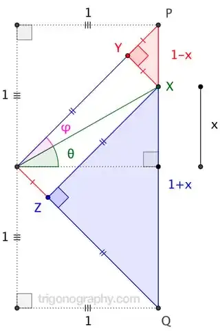

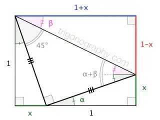

Edit. Here's a simpler trigonograph that's also purer, in the sense that it avoids auxiliary proportions in favor of relating elements in the identity more directly. It therefore requires less (or perhaps no) explanation.
$$45^\circ = \alpha + \beta = \operatorname{atan}\frac{x}{1} + \operatorname{atan}\frac{1-x}{1+x} \qquad (0 \leq x \leq 1)$$
Interestingly, this diagram has the same basic structure as my Angle-Sum and -Difference trigonographs, as well as the one for $p\sin\theta + q \cos\theta$.
My previous answer:
$$\tan \theta = \frac{x}{1} \qquad \tan \phi = \frac{|\overline{XY}|}{|\overline{XZ}|} = \frac{|\overline{XP}|}{|\overline{XQ}|} = \frac{1-x}{1+x}$$
$$\implies\qquad \operatorname{atan} x + \operatorname{atan}\frac{1-x}{1+x} = \theta + \phi = \frac{\pi}{4}$$

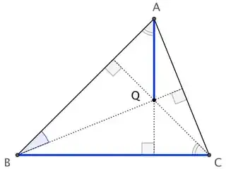

Here's an attempt to address @Michael's desire for a solution that treats the two angles symmetrically.
It's based on this preliminary result:
Lemma. If $Q$ is the orthocenter of acute $\triangle ABC$, then $$\tan \angle ABQ = \frac{|\overline{AQ}|}{|\overline{BC}|}$$
(Proof is left as an exercise to the reader. Hint: Note the congruent angles at $A$ and $C$.)

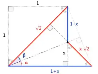

With that, we can construct the following:
$$\tan \alpha = \frac{x\sqrt{2}}{\sqrt{2}} = x \qquad \tan \beta = \frac{1-x}{1+x} \quad\implies\quad \operatorname{atan}x + \operatorname{atan}\frac{1-x}{1+x} = \alpha+\beta = \frac{\pi}{4}$$
