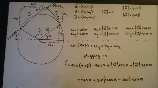

I'm trying to prove the identity $$\sin(a+b)=\sin(a)\cos(b)+\cos(a)\sin(b)$$ by using a specific vector and scalar method.
However, there has to be a mistake somewhere, since the equation at the end isn't correct. Such mistake I can't find.
I would really appreciate any help/thoughts.
Sam

  • @saulpatz. I'm having trouble explaining what $v⃗$ and $w⃗$ are in words, so I apologze if my next explanation isn't very good. Imagine that we turn the circle $a$ degrees clockwise, then, $v⃗$ would be pointing straight up, while $w⃗$ would be pointing straight to the left, also their magnitudes are defined as $1+cos(b)$ and $sin(a)$ respectively, so that $v⃗+w⃗$ is the vector which starts at the origin and points to the dot in the circle whose respective angle is $b$. – Sam Mar 11 '18 at 01:08
I get $\|w\| = 1 - \cos \beta$, not $\|w\| = \cos \beta$.
Michael Biro
  • 13,847
  • You are right! However, I still don't get that $sin(a+b)=sin(a)cos(b)+cos(a)sin(b)$ but rather that $sin(a+b)=(-1)sin(a)cos(b)+cos(a)sin(b)$ – Sam Mar 11 '18 at 00:59
  • Ah, whoops, you're right. It should really be $|w | = 1 + \cos(\beta - 90^\circ) = 1 - \cos \beta$. That should fix it. – Michael Biro Mar 11 '18 at 01:13

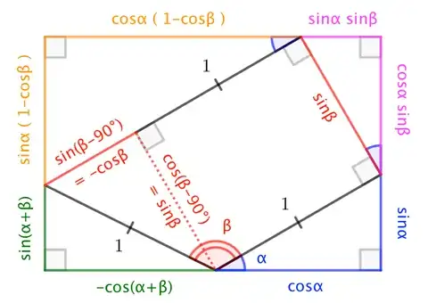

@Michael's answer identifies the error, but I thought I'd provide a comprehensive diagram. (It's kinda what I do.)
This shows
$$\begin{align} \sin(\alpha + \beta) &= \sin\alpha + \cos\alpha \sin\beta - \sin\alpha(1-\cos\beta) = \phantom{-\left(\;\right.}\sin\alpha \cos\beta + \cos\alpha \sin\beta \phantom{\left.\;\right)} \\ -\cos(\alpha+\beta) &= \cos\alpha(1-\cos\beta) + \sin\alpha \sin\beta - \cos\alpha = -\left(\;\cos\alpha\cos\beta - \sin\alpha\sin\beta\right)\; \end{align}$$
Note: The figure is valid even for non-obtuse $\beta$ (or non-acute $\alpha$), provided appropriate consideration is given to signed lengths.
Note 2: OP (and others) may be interested in a related figure of my own.
