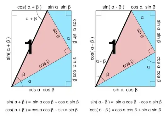

The formulas for the sum and difference of sines and cosines can be proven geometrically like in this images I found in this answer: we have geometrical proofs. nice :D

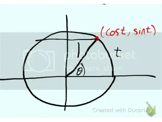

Consider the unit circle $$ \begin{equation}x^2+y^2 = 1 \end{equation} $$ Starting at the x-intercept (1,0) we travel a distance t around the circle in a counter-clockwise direction (a clockwise movement would be assigned a negative sign). Once we travel a distance t around the circle we end at a point P(x,y) on the circle. We then define $$ \begin{eqnarray} \cos t = x \\ \sin t = y \end{eqnarray} $$
It then turns out that we can return to angles by noting that on the unit circle the radian measure of the central angle subtended by the arc of length t is equal to t. But we don't need to ever actually return to angles. Our definition stands on its own. Now an immediate consequence of our definition is the familiar Pythagorean identity for sine and cosine.
$$\begin{equation} \cos^2 t + \sin^2 t = 1 \end{equation} $$
(This is obtained by substituting sine and cosine into the unit circle equation for x and y.)

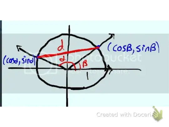

Without loss of generality assume $$0<b<a<2 \pi $$ (the case of b=0 is trivial, as is the case of a = 2 $\pi$, and the case a=b, you can verify these yourself)
diagram diagram 2

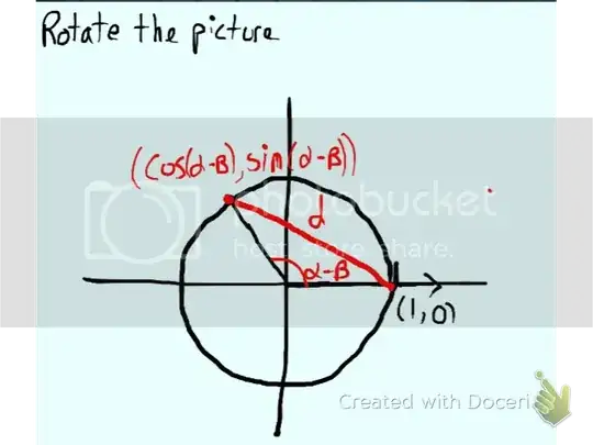

We now consider the points (see diagrams) P($\cos a, \sin b)$ and Q($\cos b, \sin b)$ on the unit circle. We can use the distance formula to find the length of segment PQ. We then rotate the entire plane clockwise through a distance b along the circumference of the circle (or through an angle with radian measure b). This will place point Q at Q`(1,0) and P will now be a distance b-a along the circle from (1,0) so it will be at P`($\cos(a-b), \sin(a-b))$. We now proceed to use the distance formula. Since distance is preserved through rotation segment PQ and segment P`Q` will have the same length.
$$\begin{eqnarray} \sqrt{(\cos a - \cos b)^2 + (\sin a - \sin b)^2} = \sqrt{(\cos(a-b)-1)^2 + (\sin(a-b) - 0)^2} \\ \cos^2 a - 2 \cos a \cos b + \cos^2 b + \sin^2 a - 2 \sin a \sin b + \sin^2 b = \cos^2(a-b) - 2 \cos(a-b) + 1 + \sin^2(a-b) \\ \cos^2 a + \sin^2 a + \cos^2 b + \sin^2 b - 2 \cos a \cos b - 2 \sin a \sin b = \cos^2(a-b) + \sin^2(a-b) + 1 - 2 \cos(a-b) \\ - 2 \cos a \cos b - 2 \sin a \sin b = - 2 \cos(a-b) \\ \cos a \cos b \sin a \sin b = \cos(a-b) \end{eqnarray} $$
Now I assumed $b<a$, is that ok? The answer is yes but you might want to answer why.

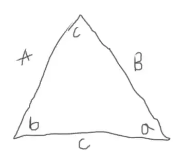

I created this shortcut proof for the cos addition formula, it uses the cosine and sine formula The proof I know usually involves complex triangle shapes, so I'll be working with a basic triangle here enter image description here
$a+b+c = \pi$, and $c = \pi -(a+b)$ $$ C^2 = A^2+B^2-2AB\cos{c}$$ $$ C^2 = A^2+B^2-2AB\cos{(\pi-(a+b))}$$ $$\frac{C^2}{A^2} = \frac{A^2}{A^2}+\frac{B^2}{A^2}-2\frac{AB}{A^2}\cos{(\pi-(a+b))}$$ $${\frac{C}{A}}^2 = 1+{\frac{B}{A}}^2-2\frac{B}{A}\cos{(\pi-(a+b))}$$ $$\frac{\sin{a}}{A} = \frac{\sin{b}}{B} = \frac{\sin{c}}{C} $$ $$\frac{\sin^2{c}}{\sin^2{a}} = 1+\frac{\sin^2{b}}{\sin^2{a}}-2\frac{\sin{b}}{\sin{a}}\cos{(\pi-(a+b))}$$ $$\sin^2{c} = \sin^2{a} \cdot ( 1+\frac{\sin^2{b}}{\sin^2{a}}-2\frac{\sin{b}}{\sin{a}}\cos{(\pi-(a+b))} )$$ $$1-\sin^2{c} = 1-\sin^2{a} \cdot ( 1+\frac{\sin^2{b}}{\sin^2{a}}-2\frac{\sin{b}}{\sin{a}}\cos{(\pi-(a+b))} )$$ $$\cos^2{c} = 1-\sin^2{a} \cdot ( 1+\frac{\sin^2{b}}{\sin^2{a}}-2\frac{\sin{b}}{\sin{a}}\cos{(\pi-(a+b))} )$$ $$\cos^2{c} = 1-\sin^2{a}-\sin^2{b}+2\sin{a}\sin{b}\cos{c}$$ $$\cos^2{c} - 2\sin{a}\sin{b}\cos{c}+\sin^2{a}+\sin^2{b}-1 = 0$$ $$\cos{c} = \frac{ 2\sin{a}\sin{b} \pm \sqrt{ (2\sin{a}\sin{b})^2-4(\sin^2{a}+\sin^2{b}-1) } }{2}$$ $$\cos{c} = \frac{ 2\sin{a}\sin{b} \pm \sqrt{ 4\sin^2{a}\sin^2{b}-4\sin^2{a}-4\sin^2{b}+4 } }{2}$$ $$\cos{c} = \frac{ 2\sin{a}\sin{b} \pm 2\sqrt{ \sin^2{a}\sin^2{b}-\sin^2{a}-\sin^2{b}+1 } }{2}$$ $$\cos{c} = \frac{ 2\sin{a}\sin{b} \pm 2\sqrt{ (1-\sin^2{a})(1-\sin^2{b}) } }{2}$$ $$\cos{c} = \frac{ 2\sin{a}\sin{b} \pm 2\sqrt{ \cos^2{a}\cos^2{b} } }{2}$$ $$\cos{c} = \sin{a}\sin{b} \pm \cos{a}\cos{b}$$ $$\cos{(\pi-(a+b))} = \sin{a}\sin{b} - \cos{a}\cos{b}$$ $$-\cos{(a+b)} = \sin{a}\sin{b} - \cos{a}\cos{b}$$ $$\cos{(a+b)} = \cos{a}\cos{b}- \sin{a}\sin{b}$$
