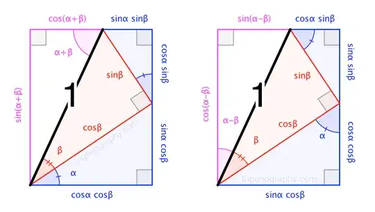

This website has a lot of cool stuff about trigonometry.
https://trigonography.com/2015/09/28/angle-sum-and-difference-for-sine-and-cosine/ enter image description here
