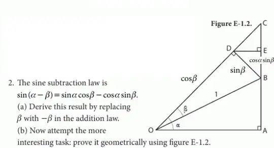

I can't solve the following problem (From the book: The Forgotten Art of Spherical Trigonometry):
I can't manage to prov it geometrically.

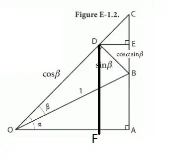

I could get that I have to find AB and the values indicated in the diagram. I also think that D angle in DCE is equal to alpha as B in BED is, making DCE and BED similar, but then I always get very complicated calculation when I try to give a dimension to CE or DC.
How it is the smart way?

Hint: Sine is an odd function so $$\sin(-\beta) = -\sin(\beta)$$

$$AB = DF - BE $$
where:
$AB = OB\sin(\alpha - \beta) = \sin(\alpha - \beta)$
$DF = OD\sin \alpha = \cos\beta\sin\alpha$
$BE = BD\cos \alpha = \sin\beta\cos\alpha$
Since $DEAO$ is a parallelogram, $\angle CDE = \alpha$.
Since $\angle DEB$ is a right angle, $\angle EBD = \alpha.$
From there you can calculate $CD, DE, CE$.
Then, by writing down $CA = CE + EB + BA,$
$$\sin \alpha (\cos \beta + \tan \alpha \sin \beta) = \sin \alpha \tan \alpha \sin \beta + \cos \alpha \sin \beta + \sin(\alpha - \beta),$$
the result follows by algebra.
