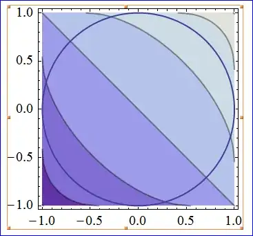

Hope the graph explains the x,y domain ( |x|< 1, |y|< 1 ) and range.
Arcsinx,..&y
