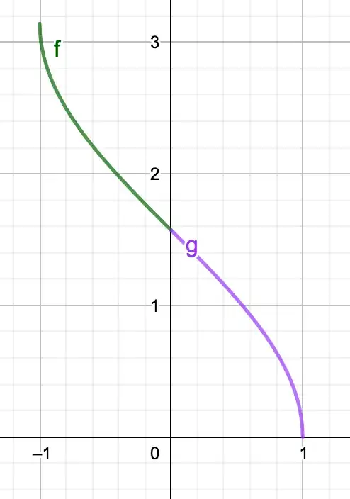

which can be seen from the graph below,
Here is a brief analytic proof. Let $\theta = \cos^{-1}x$ with the range $\theta\in[0,\pi]$. Then,
$$\cos\theta = x\implies \sin\theta = \sqrt{1-x^2}$$
which over $\theta\in[0,\pi]$ has two solutions
$$\theta= \sin^{-1}\sqrt{1-x^2},\>\>\>\>\>\theta= \pi-\sin^{-1}\sqrt{1-x^2}$$
corresponding to $x\in[0,1]$ and $x\in[-1,0]$, respectively.

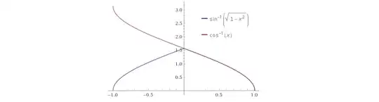

$$cos^{-1}x = \begin{cases} sin^{-1}\sqrt{1-x^2}, \space x \geq 0\\\\ \pi-sin^{-1}\sqrt{1-x^2} , x < 0\end{cases}$$
This can be proven graphically also as shown: image
