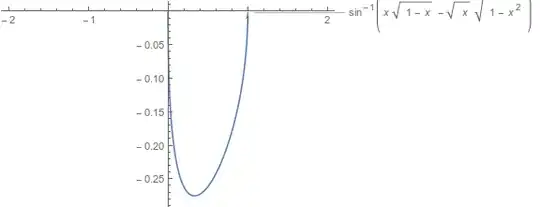

Then I'll get: $$ y=\sin^{-1}[\sin a\cos b-\cos a\sin b]=\sin^{-1}[\sin(a-b)]\\ \implies\sin y=\sin(a-b)\\ \implies y=n\pi+(-1)^n(a-b)=n\pi+(-1)^n(\sin^{-1}x-\sin^{-1}\sqrt{x}) $$ Thus, $$ y'=\frac{d}{dx}\big[n\pi+(-1)^n(a-b)\big]=\begin{cases}\frac{1}{\sqrt{1-x^2}}-\frac{1}{2\sqrt{x}\sqrt{1-x}}\text{ if }n\text{ is even}\\ -\bigg[\frac{1}{\sqrt{1-x^2}}-\frac{1}{2\sqrt{x}\sqrt{1-x}}\bigg]\text{ if }n\text{ is odd} \end{cases} $$ Is it the right way to solve this problem and how do I check the solution is correct ?
Note: I think there got to be two cases for the derivative as the graph of the function is

Let $\sin a=x\implies a=\sin^{-1}x$ and $\sin b=\sqrt{x}\implies b=\sin^{-1}\sqrt{x}$ $$ y=\sin^{-1}\Big[ \sin a|\cos b|-\sin b.|\cos a| \Big]\\ $$ $0<x<1\implies 0<\sin^{-1}x=a<\frac{\pi}{2}\implies |\cos a|=\cos a$ and
$0<x<1\implies 0<\sqrt{x}<1\implies0<\sin^{-1}\sqrt{x}=b<\frac{\pi}{2}\implies|\cos b|=\cos b$ $$ \begin{align} y&=\sin^{-1}\Big[\sin a\cos b-\cos a\sin b\Big]\\ &=\sin^{-1}\big[\sin(a-b)\big] \end{align} $$ We have $0<x<\frac{\pi}{2}$ and $0<b<\frac{\pi}{2}\implies \frac{-\pi}{2}<-b<0$, Hence $\frac{-\pi}{2}<a-b<\frac{\pi}{2}$ $$ y=\sin^{-1}\big[\sin(a-b)\big]=a-b=\sin^{-1}x-\sin^{-1}\sqrt{x} $$ $$ \begin{align} \color{blue}{\frac{dy}{dx}}&\color{blue}{=\frac{1}{\sqrt{1-x^2}}-\frac{1}{2\sqrt{x}\sqrt{1-x}}}\\ &=\frac{2\sqrt{x}\sqrt{1-x}-\sqrt{1-x^2}}{2\sqrt{x}\sqrt{1-x}\sqrt{1-x^2}} =\frac{\sqrt{1-x}(2\sqrt{x}-\sqrt{1+x})}{2\sqrt{x}\sqrt{1-x}\sqrt{1-x^2}} \end{align} $$ $y'<0$ when $2\sqrt{x}<\sqrt{1+x}\implies 4x<1+x\implies 0<x<\frac{1}{3}$
$y'<0$ when $\frac{1}{3}<x<1$
