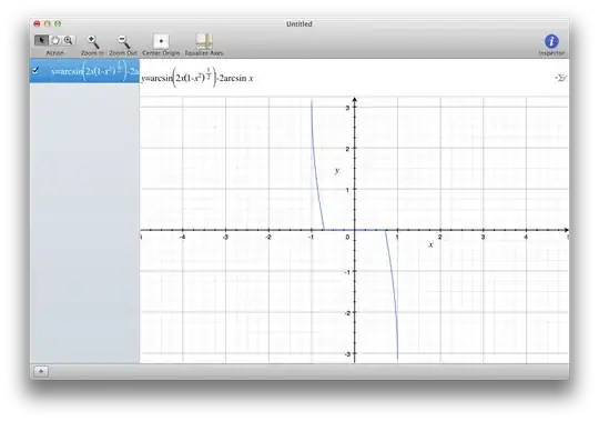

Consider the function $$ f(x)=\arcsin(2x\sqrt{1-x^2})-2\arcsin x $$ which is defined in the domain where $$ \begin{cases} |2x\sqrt{1-x^2}|\le 1\\[4px] |x|\le 1 \end{cases} $$ The first inequality becomes, writing $t=|x^2|$, $$ 4t-4t^2\le 1 $$ that's satisfied for every $t$. So our function $f$ is defined over $[-1,1]$.
The derivative of $f$ is $$ f'(x)=\frac{1}{\sqrt{1-4x^2(1-x^2)}}\left(2\sqrt{1-x^2}-\frac{2x^2}{\sqrt{1-x^2}}\right)-\frac{2}{\sqrt{1-x^2}} $$ that can be simplified to $$ f'(x)=\frac{2}{\sqrt{1-x^2}} \left(\frac{1-2x^2}{|1-2x^2|}-1\right) $$ The derivative exists in the set $$ (-1,-1/\sqrt{2})\cup(-1/\sqrt{2},1/\sqrt{2})\cup(1/\sqrt{2},1) $$ and it can be simplified further as $$ f'(x)=\begin{cases} -\dfrac{4}{\sqrt{1-x^2}} & \text{for $1/\sqrt{2}<|x|<1$}\\[8px] 0 & \text{for $|x|<1\sqrt{2}$} \end{cases} $$
Thus the function is constant over $[-1/\sqrt{2},1/\sqrt{2}]$ (also at the extremes, by continuity). Since $f(0)=0$, we have that the given identity is valid on this interval and nowhere else, because over $[-1,-1/\sqrt{2}]$ and $[1/\sqrt{2},1]$ the function is strictly decreasing.
