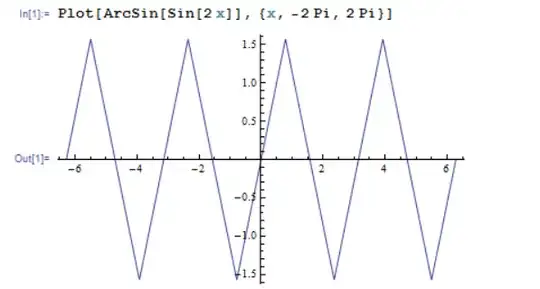

Remember that $\sin^{-1}$ is not a "true inverse". Here is a graph of $\sin^{-1}(\sin(2x))$.
I think it is clear that this is the most likely source for your sign error. As you note, you could have a different choice for arcsin which would give you the opposite sign when differentiating.
I think the easiest way to reason into the first choice is that because $\sin^{-1}(x)$ is increasing your derivative should be positive.
If you wanted to be more precise, remember that you are only considering values of $x$ such that $-1 \leq 2x\sqrt{1-x^2} \leq 1$. If you let $x = \cos\theta$ you will use values of theta that are greater than $\pi/2$ because you need $x$ to be negative. If you let $x = \sin(\theta)$ you can let $\theta$ take on values between $-\pi/2$ and $\pi/2$ which is where $\sin^{-1}$ is "nicely defined".
