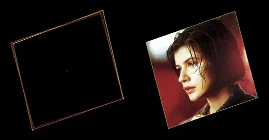

I'm working on a project using Chrome - JS and WebKit 3D CSS3 transform matrix. The final goal is to create a tool for artistic projects using projectors and animation - somewhat far away from using maths...
I'm using a projector to project several squares over several shapes - as seen in the picture. What I would like to do is for the user to draw $4$ points on the screen (2D $x$ and $y$) and from there extract a matrix object that I could apply to a regular DIV element of a dimension of 100px by 100px. By finding scaleX, scaleY, rotation, rotationX, rotationZ and probably some perspective that I could apply to the div to relatively match the surface. I'm not really familiar with geometry beyond $\sin$ and $\cos$, and 3D in general and don't even know if that is something doable. If anyone could help me get started or point me in the right direction, I would greatly appreciate.
Here is an animated GIF (click to enlarge), hoping it makes it more clear to understand.
http://www.michael-iriarte.com/code/duncan.gif
