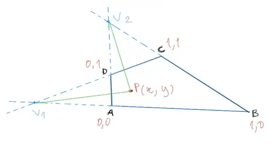

I could do a line intersection between, say, PV1 and AB and then project that onto AB to find the factor, but I'm wondering if there's an easier way.

  • Are you sure the coordinates of $B$ are $(1,1)$? – Rodrigo de Azevedo May 01 '17 at 18:50
  • Ah ok, let me update the drawing. A an B could be on the bottom I guess. – probiner May 01 '17 at 18:52
  • How can $A$ and $B$ have the same height? – Rodrigo de Azevedo May 01 '17 at 18:54
    Build vectors $CD, DA, AB, BC$. Now $OC +k_1CD+k_2DA+k_3AB+k_4BC, k_i \in [0,1]$ can represent any position inside. – mathreadler May 01 '17 at 18:54
  • Rodrigo, those coordinates there the ones that I want my position P to fit, not their current coordinates, but the Bounding Box which is sampling the distortion of that 2D space. – probiner May 01 '17 at 18:56
  • What exactly do you want? To find any point inside $ABCD$? – Rodrigo de Azevedo May 01 '17 at 19:13
  • @RodrigodeAzevedo This should illustrate well what I want to do. I have ABCD positions but I need the relative position that fits that bounding box. http://i.imgur.com/mkX6PlG.png – probiner May 01 '17 at 19:35
  • @methread sorry, I'm bit of a Math illiterate. What is k1? What does that funny E [0,1] means? So you're saying that will only work for position inside the "quad"? – probiner May 01 '17 at 19:36
  • I don't know what "relative position that fits that bounding box" means. – Rodrigo de Azevedo May 01 '17 at 19:54
  • Please use mathematical notation to clearly state your question. Images and text are ambiguous. – Rodrigo de Azevedo May 01 '17 at 20:06
    Looks like you want to find some coordinate transformation that maps the quadrilateral to a unit square. A planar perspective transformation is a reasonable choice. You can find plenty of references to this in the Internet, and it’s available as a standard function in many computer graphics packages. I describe one way of deriving the appropriate transformation here. It’s also not hard to derive the mapping directly if you’re used to working with homogeneous coordinates. – amd May 01 '17 at 22:09

    The fact that the two intersection points of the extensions of the sides are labeled with the letter ‘V’ suggests that they are meant to be vanishing points, in which case a two-point perspective is indeed what you’re working with. – amd May 02 '17 at 15:22

Let’s expand on your idea first. It’s easy to find the lines $\overline{V_1P}$ and $\overline{V_2P}$ and their intersections with the sides of the quadrilateral. (I’m assuming that’s what you meant since if you’re just going to project onto the sides, there’s no particular reason to involve $V_1$ and $V_2$). You can then find the portion of the distance along the side that this intersection represents with a division.

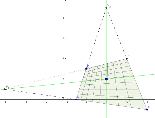

Working in homogeneous coordinates, we have $V_1=(A\times B)\times(C\times D)$ and $V_2=(A\times D)\times(B\times C)$. Choose two adjacent sides for your references, let’s say $AB$ and $AD$. $\overline{PV_1}$ and $\overline{AD}$ intersect at $P_1=(P\times V_1)\times(A\times D)$. (This method of using cross products to find the intersection of lines is Cramer’s rule in disguise.) Convert to Cartesian coordinates and then divide the difference between $x$- or $y$-coordinates of $P_1$ and $A$ by the difference between the corresponding coordinates of $D$ and $A$ (whichever difference is non-zero). This will give you a “$y$-offset” of $P$ relative to the quadrilateral. A similar computation will give you the “$x$-offset.”
For example, let the four corners be $A(1,0)$, $B(8,-1)$, $C(6,4)$, $D(2,3)$. We thus have $V_1=((1, 0, 1)\times(8, -1, 1))\times((6, 4, 1)\times(2, 3, 1))=(66,-11,-11)$, which is $(-6,1)$ in Cartesian coordinates. $V_2=(44,88,11)$, which is $(4,9)$ in Cartesian coordinates. Taking $P(4,2)$, we can compute $$\begin{align}P_1 &= ((4,2,1)\times V_1)\times(A\times D) \\ &= (506,561,319)\end{align}$$ which is $\left(\frac{46}{29},\frac{51}{29}\right)$ in Cartesian coordinates. $D-A=(1,3)$, so I’ll choose to work with $x$-coordinates of these points to get the “$y$-offset”: $\left(\frac{46}{29}-1\right)/1=\frac{17}{29}\approx0.586$. I’ll leave working out the “$x$-offset” to you.
The above is a fairly straightforward computation, but the method has a possible flaw depending on what you want this number for: the offsets depend on the sides that you chose. If we redo the above computation with $BC$ instead of $AD$, we end up with $0.654$ instead. There’s a fairly simple way to ensure that the offsets at both sides are consistent, and that’s to treat the quadrilateral as a perspective projection of the unit square. This answer gives a straightforward way to construct the necessary projection matrix; this answer has an explicit, albeit more complicated direct formula.
Following the construction in the first link, first compute the matrix $D$ that maps the standard basis to the unit square (this will be the same for all quadrilaterals that you are trying to rectify): $$\begin{bmatrix}0&1&0\\0&0&1\\1&1&1\end{bmatrix}^{-1}\begin{bmatrix}1\\1\\1\\\end{bmatrix}=\left[\begin{array}{r}-1\\1\\1\end{array}\right]$$ so $$D=\begin{bmatrix}0&1&0\\0&0&1\\1&1&1\end{bmatrix}\left[\begin{array}{rcc}-1&0&0\\0&1&0\\0&0&1\end{array}\right]=\left[\begin{array}{rcc}0&1&0\\0&0&1\\-1&1&1\end{array}\right].$$ For the mapping $S$ from the standard basis to the above quadrilateral we have: $$\left[\begin{array}{crc}1&8&2\\0&-1&3\\1&1&1\end{array}\right]^{-1}\begin{bmatrix}6\\4\\1\end{bmatrix}=\left[\begin{array}{r}-1\\\frac12\\\frac32\end{array}\right]$$ and so $$S=\left[\begin{array}{crc}1&8&2\\0&-1&3\\1&1&1\end{array}\right]\left[\begin{array}{rcc}-1&0&0\\0&\frac12&0\\0&0&\frac32\end{array}\right]=\left[\begin{array}{rrc}-1&4&3\\0&-\frac12&\frac92\\-1&\frac12&\frac32\end{array}\right].$$ The projective map that takes the quadrilateral to the unit square is then given by the matrix (using the adjugate instead of the inverse as recommended)$$M=DS^{adj}=\left[\begin{array}{crr}-\frac92&\frac32&\frac92\\-\frac12&-\frac72&\frac12\\-2&\frac52&-\frac{29}2\end{array}\right].$$ (You can multiply this matrix by $2$ or any other non-zero constant to simplify further calculations without affecting the results.) We can check a couple of the corners: $M[1,0,1]^T=[0,0,-33/2]^T$, which is equivalent to Cartesian $(0,0)$ and $M[8,-1,1]^T=[-33,0,-33]^T$, which is Cartesian $(1,0)$ as required. Applying this matrix to $P$ results in $\left[-\frac{21}2,-\frac{17}2,-\frac{35}2\right]^T$, which in Cartesian coordinates is $\left(\frac35,\frac{17}{35}\right)\approx(0.6,0.486)$.
The order of the four corner points doesn’t matter when building these matrices as long as you use a consistent order for both.
Effectively, using a perspective projection builds a non-uniformly spaced grid on the quadrilateral. You give up a uniform spacing along an edge, but you gain consistency along lines through $V_1$ and $V_2$, which are the vanishing points of the perspective. If your quadrilateral is the result of a perspective projection in the first place, this, of course, is the correct way to invert the mapping.
