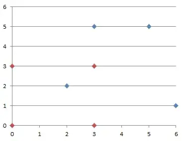

I want to transform an image.
As far as I was able to find out, I can achieve this with a matrix, right?
So here is my problem: how do I get this matrix if the only thing I know are the following starting and ending points?
$$\begin{matrix} \text{Starting Points} & \text{Target Points} \\ \mathrm{TL}(3,5) & \mathrm{TL}'(0,3) \\ \mathrm{TR}(5,5) & \mathrm{TR}'(3,3) \\ \mathrm{LL}(2,2) & \mathrm{LL}'(0,0) \\ \mathrm{LR}(6,1) & \mathrm{LR}'(3,0) \end{matrix}$$
