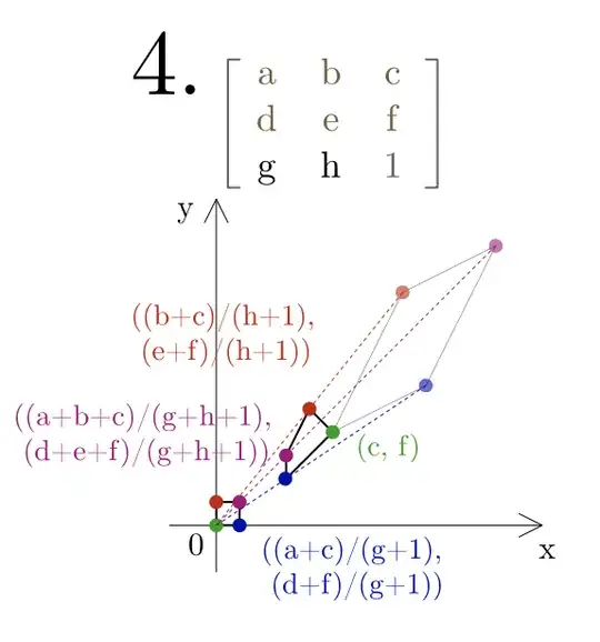

Perhaps, you could use perspective projection matrix in homogenous coordinates.
Perspective transformation matrix, transforming uniq square
Reversing this operation is just a matter of finding an inverse of this transformation matrix.
This will work for many cases. However, it doesn't map to any quadrilateral. For one, I think, the quadrilateral will still have to be convex.
(Image source: Wikimedia Commons, Author: D.stebani, License: CC BY-SA 4.0)
