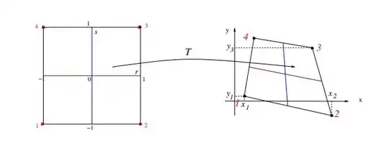

What is the generalisation of this in 2D space (or higher), in other words, what is the function $T$ such that $T$ maps the square $\{(1,1);(-1,1);(-1,-1);(1,-1)\}$ into a quadrilateral $\{(x_1,y_1);(x_2,y_2);(x_3,y_3);(x_4,y_4)\}$
