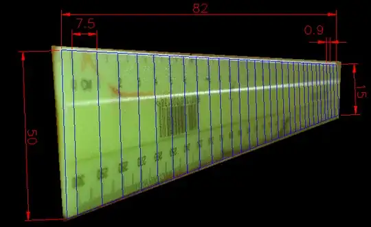

If I have a photograph of a rectangular object whose image recedes with perspective, is it possible to work out the scale of measurements along that object?
For example: I have a photograph of a (metric) ruler.
The ruler is graduated in centimetres as shown, 30 cms.
Is it possible to work out the distance between each centimetre?
The screenshot shows the photograph.
The representation on the Picture Plane shows the nearest edge of the ruler to be 50mm and the farthest edge to be 15mm. By measuring the photo, I see that the distance between 0 and 1 is 7.5mm and the distance between 27 and 28 is 0.9mm.
Is there a way to get these results from a formula?
It doesn't need to be 100% accurate: it's for photometric software I'm writing, so it's only going to be used as a rough guide.
Photo of ruler

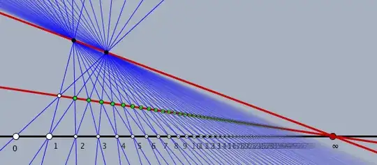

Constructing a projective scale
Points at integral positions along a perspectively deformed scale can also be constructed geometrically. Here is an interactive illustration of that construction. The site is in German (so far), so here is an explanation:
Static snapshot of applet from referenced site
$0$, $1$ and $\infty$ fix your scale. Draw two arbitrary lines through $\infty$. Choose an arbitrary point on the lower line (drawn in white) and connect it to $0$ and $1$. You obtain two points on the upper line (drawn in black). Then start by the maximal point you have so far, i.e. $1$, connect to the right black point, intersect with the lower line, connect to the left black point, intersect with the line of the scale, and you obtain $2$. The steps to go from $i$ to $i+1$ are the same for all $i\in\mathbb N$.

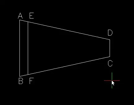

    Fig 1
    I drew the rectangle ABCD in perspective using the measurements given above. I then drew E-F which is 7.5mm from A-B which represents the graduation at 1cm. I could have chosen any distance but have decided to use the value from the photograph.

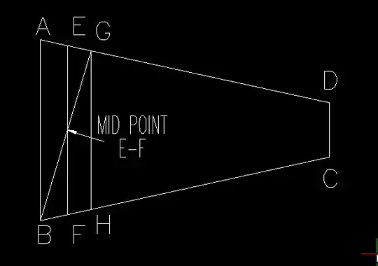

    I then drew a line from B through the mid point of E-F.
    Fig2
    – Dave Coventry Dec 20 '13 at 11:29
  • ...continued:I extended this line to intersect the line A-D. I then drew the line G-H.

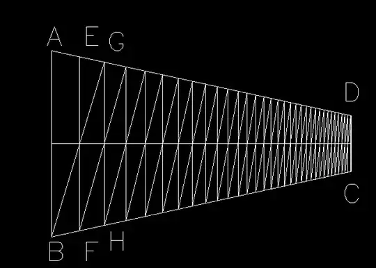

    I repeated this until I had all the divisions marking the graduation of the ruler. Happiness!

  • @DaveCoventry: Keep in mind that midpoints are not a projective invariant: there are perspectives which will map the midpoint to something other than the midpoint. In your photo it only works because all your graduation lines are still parallel in the image. If that will always be the case, you are fine, otherwise you should rather use this scale construction from my last paragraph. – MvG Dec 20 '13 at 11:34

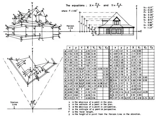

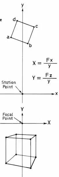

These two vector equations can define any points in perspective by inputting x,y,z coordinates of points for the object and outputting X,Y coordinates in perspective. Keep in mind that perspective projections can look different when the camera is tilted for bird's eye views. Thus, a tilt angle of the camera can be incorporated into the equations. Anyway, try to test them, then I can give you more details about their application. These are Murran's perspective equations. equations applied to a cube
equations applied to a house plan
