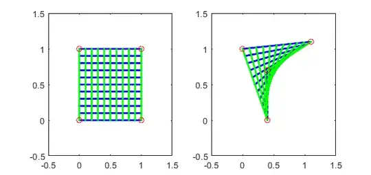

EDIT: As @amd commented, this doesn't work for nonconvex quadrilaterals, here the plot of such an example:
flawr
  • 16,931
  • Very nice. This has some problems when $Q$ is not convex, though. No matter how you order the vertices, the forward map sends some points of $U$ to points outside of $Q$. – amd Jan 11 '19 at 20:44
  • @amd You're totally right, I made a plot that visualizes this problem! – flawr Jan 11 '19 at 22:02
