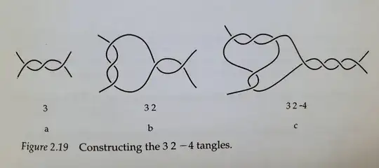

Conway's rational tangles, continued fractions, and the "greedy" Euclidean algorithm!
Here are some Math Circles notes by Tom Davis on the topic. You're going to want to have two pieces of thick rope, at least 10 feet in length, and hopefully have at least 4 volunteers to hold the ends for a very fun interactive activity.
Figure from p. 43 in The Knot Book by Colin C. Adams
Pictured: construction of the tangle $$ -4 + \frac{1}{2+\frac{1}{3}} = -\frac{25}{7} $$

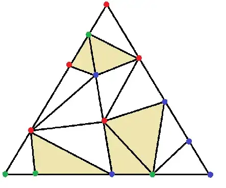

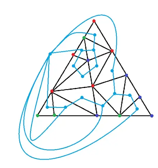

The $2$-dimensional case of Sperner's lemma is a good introduction to graph theory. The proof is self-contained aside from using the Handshaking lemma, which is also easy to show. Take a triangle and subdivide it into several smaller triangles. Call a triangle minimal if it contains no other triangles. If whenever two minimal triangles touch, they share a side, then we call this subdivision a triangulation. (This is to avoid the possibility that the side of one minimal triangle is part of a side of another triangle.)
Color the nodes of the original triangle three colors, say red, blue, and green. Then color all of the other nodes with those colors, under the condition that if a node lies on a side of the original triangle, then it has to be given one of the colors used for the original two nodes of that side. Nodes inside the triangle can be given any of the three colors. See the picture below. (Apologies for the poor quality- this was made in mspaint and then hastily resized.) Observe that there's a red-blue side, a red-green side, and a blue-green side.
There are five minimal triangles that have a vertex of each color. Sperner's lemma states that there must always be a minimal triangle with a node of each color, and in fact, there must be an odd number of such triangles. To see this, we will construct a graph from this triangulation. We do so by associating a vertex to each face, including the outside face, and draw an edge between two vertices if the side shared by their corresponding triangles has two different colors. See the picture below.
The internal vertices can have degree either $0$, $2$, or $3$. The degree is $0$ if the nodes of the corresponding triangle all have the same color, $2$ if the nodes use two different colors, and $3$ if the nodes all use different colors. We want to show that there are an odd number of internal vertices of odd degree. The Handshaking Lemma tells us that a graph must have an even number of vertices with odd degree, so if we can show that the outside vertex has odd degree, then the lemma follows. For example, the outside vertex in our picture has degree $7$.
To see this, look at any side of the original graph, say the red-green side. Moving from the red node to the green node, that side contributes $1$ whenever the colors switch from red to green or green to red. Since we start with a red node and end with a green node, there must be an odd number of switches. Hence, each side of the original triangle makes an odd contribution to the degree of the outside vertex so the outside vertex has odd degree. By the Handshaking Lemma, Sperner's Lemma follows.
