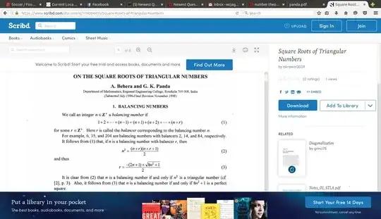

this question has been repeated quite a bit lately. Here is where these numbers were introduced, in 1999, in The Fibonacci Quarterly. Notice how they say $n$ is such a number if and only if $\sqrt {8n^2 +1}$ is a square. It is not on this page, but the simplest description for isolating $n$ is the degree two linear recurrence, $$ n_{j+2} = 6 n_{j+1} - n_j, $$ which means you can write $n_j$ as $A \lambda_1^j + B \lambda_2^j,$ with real constants $A,B$ and the lambdas are the two roots of $$ \lambda^2 - 6 \lambda + 1 = 0. $$ Alright, $$ n_j = A \left( 3 + \sqrt 8 \right)^j + B \left( 3 - \sqrt 8 \right)^j$$ with $n_0 = 1, n_1 = 6, n_2 = 35,$ and so on.
