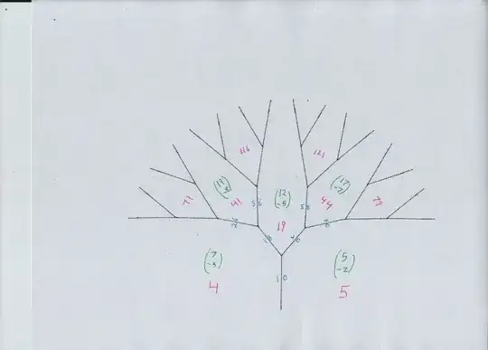

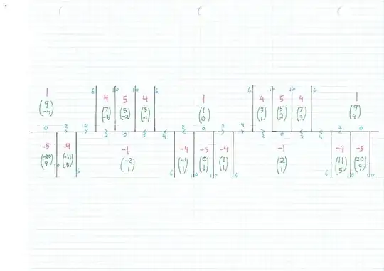

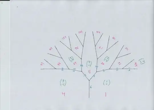

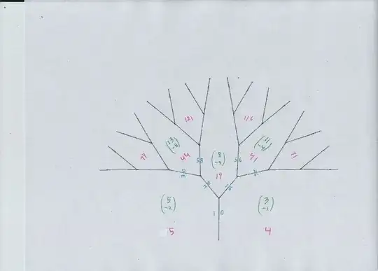

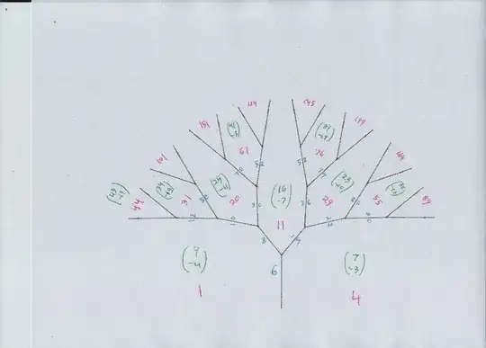

A way to be sure that all solutions have been found in a Pell type problem is Conway's topograph diagram. The way I draw it now is one main diagram of the "river," then one or more trees growing off the river. The conclusion is that all solutions to $$ u^2 - 5 v^2 = 44 $$ come from tree locations (green vectors) $$(32,-14), (43,-19),(17,-7),(13,-5),(16,-4),(8,-2). $$ Note that $(32, -14)$ is simply double $(16,-7),$ because the latter is a representation of $11.$ Same with $(8,-2).$

And these are the diagrams, river and trees i called A,B,C,D...
enter image description here enter image description here enter image description here enter image description here enter image description here
