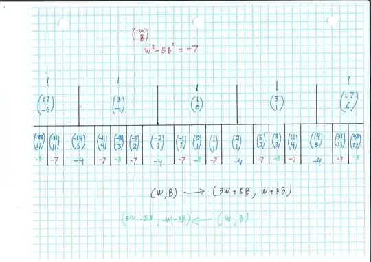

Here is the simpler of two diagrams I did for $x^2 - 8 y^2.$ All I mean by the automorphism group is the single formula $$ (3x+8y)^2 - 8 (x+3y)^2 = x^2 - 8 y^2, $$ with the evident visual column vector $(3,1)^T$ giving a form value of $1$ and the column vector $(8,3)^T$ directly below it giving a form value of $-8,$ thus replicating the original form.

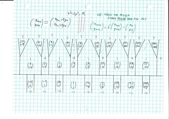

This is another pretty recent, the very similar $x^2 - 2 y^2,$ where I was emphasizing finding all solutions to $x^2 - 2 y^2 = 7,$ and how there is more than one "orbit" of the automorphism group involved, i.e. every other pair...
