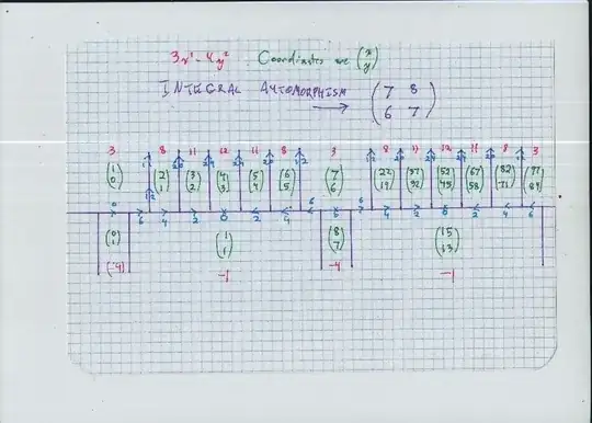

As $11$ is prime, there are two orbits; one sequence of $x$ values is $$ 3, \; \; 37, \; \; 515, \; \; 7173, \ldots $$ with $$ x_{n+2} = 14 x_{n+1} - x_n, $$ with matching $y$ values $$ 2, \; \; 32, \; \; 446, \; \; 6212, \ldots $$ $$ y_{n+2} = 14 y_{n+1} - y_n. $$
Here is the second orbit: sequence of $x$ values is $$ 5, \; \; 67, \; \; 933, \; \; 12995, \ldots $$ with $$ x_{n+2} = 14 x_{n+1} - x_n, $$ with matching $y$ values $$ 4, \; \; 58, \; \; 808, \; \; 11254, \ldots $$ $$ y_{n+2} = 14 y_{n+1} - y_n. $$
The linear recurrences above come from Cayley-Hamilton for the matrix $$ \left( \begin{array}{cc} 7 & 8 \\ 6 & 7 \\ \end{array} \right) $$

    @mvw see references I put in the answer now. Worth the effort to draw the topograph for $3x^2 - 4 y^2,$ out enough layers to find all occurrences of $11.$ – Will Jagy Dec 25 '17 at 01:17
  • @KennyLau see references I put in the answer now. Worth the effort to draw the topograph for $3x^2 - 4 y^2,$ out enough layers to find all occurrences of $11.$ – Will Jagy Dec 25 '17 at 01:17
  • Can it be one orbit if we propagate the recursion in both directions? – Oscar Lanzi Dec 25 '17 at 01:27
  • That is great stuff. Thank you very much. – mvw Dec 25 '17 at 01:37
  • @OscarLanzi yes, exactly. I have posted the diagram, enough for you to run the automorphism (inverse matrix) backwards and get negative $y,$ repeating the other orbit of positive $x,y$ – Will Jagy Dec 25 '17 at 02:07
  • @mvw I put in part of the diagram. The linear recursion is Cayley-Hamilton for the "automorphism" matrix – Will Jagy Dec 25 '17 at 02:09
