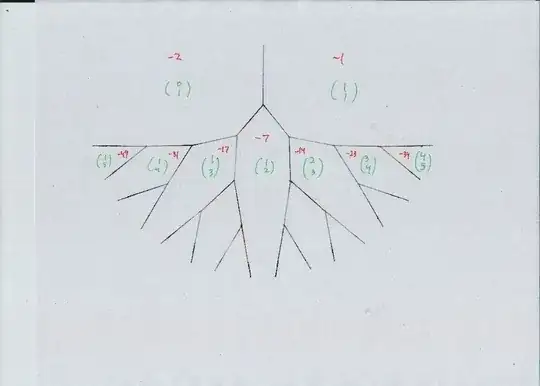

  • just realized the possible significance of your absolute value signs. If you are willing to have, with $k >0,$ the representation $u^2 - 2 v^2 = -k,$ then you actually do achieve the bounds you wanted, $$ u \leq \sqrt k, ; ; v \leq \sqrt k. $$ Diagram and summary edited into answer. – Will Jagy Apr 05 '15 at 22:11
  • Not by the way, $-k$ is represented if and only if $k$ is represented. – Will Jagy Apr 05 '15 at 22:14

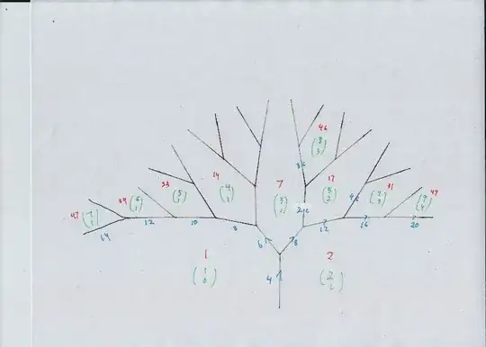

Appendix 1: all pairs $(u,v)$ in the tree depicted satisfy $u \geq 2v.$ As a result, $$ k = u^2 - 2 v^2 \geq 4 v^2 - 2v^2 = 2 v^2, $$ so $$2 v^2 \leq k$$ and $$ \color{blue}{ v \leq \sqrt {\frac{k}{2}}}. $$
Appendix 2: we may demand $$ v \leq \frac{u}{2}. $$ Therefore $$ 2 v^2 \leq \frac{u^2}{2}, $$ $$ -2 v^2 \geq - \frac{u^2}{2}, $$ $$ k = u^2 -2 v^2 \geq u^2 - \frac{u^2}{2} = \frac{u^2}{2}, $$ $$ u^2 \leq 2 k, $$ $$ \color{blue}{ u \leq \sqrt {2k}}. $$
preliminary: I already think you are roughly correct. The Conway topograph method deals most directly with $u+v$ when both are positive. The largest variables come from $$ u = 2n + 1, \; \; v = n, \; \; u^2 - 2 v^2 = 2 n^2 + 4 n + 1 $$ Note that this "branch" of the tree illustrates both inequalities well, $ u \leq \sqrt {2k} $ and $ v \leq \sqrt {\frac{k}{2}}. $
I have answered several questions with these diagrams, also the book describing the method is at CONWAY. The point is that any (positive) number represented occurs in the first tree on the positive side of the river:
Just noticed the absolute values in the original question. If you are willing to represent $-k$ instead of $k,$ you get the bounds you wanted. This happens in an upside-down tree below the river where we have $u^2 - 2 v^2 = -k$ for positive $k,$ and with $u,v > 0$ and $v \geq u.$ Similar arguments to the above give your desired bounds, $$ u \leq \sqrt k, \; \; \; v \leq \sqrt k. $$

  • @EwanDelanoy, that is the real story, how we decide on size of a pair $(u,v).$ I just got one case which gives an explicit bound on $v.$ Typing... – Will Jagy Apr 05 '15 at 18:14
  • "we may demand $v\leq \frac{u}{2}$" in appendix 2? How so ? – Ewan Delanoy Apr 05 '15 at 18:30
  • @EwanDelanoy, every (primitively) represented positive number is represented in the tree depicted; any two $(u,v)$ pairs in the tree, depicted as a (green) column vector, have $u \geq 2 v,$ and add up to a new pair one number out which still satisfies $u \geq 2v,$ as $(3,1) + (5,2) = (8,3).$ – Will Jagy Apr 05 '15 at 18:37
  • @EwanDelanoy, I suspect you can make an argument with no diagrams, given positive $(u,v)$ with positive $k$ and the ratio $v/u$ not big enough, repeatedly use the mappng $$ (u,v) \mapsto (3u-4v, -2u+3v) $$ – Will Jagy Apr 05 '15 at 18:40
  • The question has now become, can $|u|\leq \sqrt{2k}$ be strengthened to $|u|\leq \sqrt{k}$ ? – Ewan Delanoy Apr 05 '15 at 18:44
  • @EwanDelanoy, no, in the middle I give the example along the right branch, $u = 2n+1, v=n, k = 2n^2 + 4 n + 1.$ For prime $k$ we are allowed only one $(u,v)$ pair in this tree. For example, $k=31.$ – Will Jagy Apr 05 '15 at 18:50
