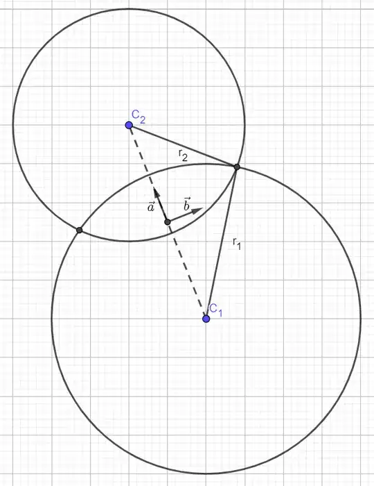

Easy solution is to consider another plane such that the centers are along an axis.
Given the points $(x_1,y_1)$ and $(x_2,y_2)$. We focus on the center point of both circles given by $$ \left( \frac{x_1+x_2}{2}, \frac{y_1+y_2}{2} \right). $$
The distance between the centers of the circles is given by $$ R = \sqrt{ (x_2-x_1)^2 + (y_2-y_1)^2}. $$
We can consider the following orthogonal vectors $$ \vec{a} = \left( \frac{x_2-x_1}{R}, \frac{y_2-y_1}{R} \right), \vec{b} = \left( \frac{y_2-y_1}{R}, - \frac{x_2-x_1}{R} \right). $$
a b coordinate plane
In the $(\vec{a},\vec{b})$ plane we get the equations $$ \big( a + R / 2 \big)^2 + b^2 = r_1^2,\\ \big( a - R / 2 \big)^2 + b^2 = r_2^2. $$
Whence $$ a = \frac{r_1^2 - r_2^2}{2R},\\ b = \pm \sqrt{ \frac{r_1^2+r_2^2}{2} - \frac{(r_1^2-r_2^2)^2}{4R^2} - \frac{R^2}{4}}. $$ The intersection points are given by $$ (x,y) = \frac{1}{2} \big( x_1+x_2, y_1+y_2 \big) + \frac{r_1^2 - r_2^2}{2R^2} \big( x_2-x_1, y_2-y_1 \big)\\ \pm \frac{1}{2} \sqrt{ 2 \frac{r_1^2+r_2^2}{R^2} - \frac{(r_1^2-r_2^2)^2}{R^4} - 1} \big( y_2-y_1, x_1-x_2 \big), $$ where $R$ is the distance between the centers of the circles.
    A new user has some questions about this, can't comment here. Can you help him please? http://math.stackexchange.com/questions/1899322/circle-cirle-intersection – iamvegan Aug 21 '16 at 20:12
    It would be helpful to include a geogebra sketch of this solution. I have trouble visualizing it also. – John Alexiou Aug 21 '16 at 21:20
    Wrote some JS code that implements this. Should be easy to port to other languages: https://gist.github.com/jupdike/bfe5eb23d1c395d8a0a1a4ddd94882ac – Jared Updike Jan 12 '17 at 21:10
  • in the scenario where two circles overlap , do you express this R=0 condition? – Charles Chow Oct 05 '19 at 21:50
    There is only one plane in $\mathbb{R^2}$, and this is $\mathbb{R^2}$. What you do is the change of the coordinate plane or coordinate system. $(\vec{a},\vec{b})$ do not define a coordinate plane you additionally need an origin which should be $\left( \frac{x_1+x_2}{2}, \frac{y_1+y_2}{2} \right)$, I think. You do not explain what a and b is, and why they satisfy these equations. To deduce the final equation one dos not need a complicate concept like transformation of coordinate systems, that is simple analytic geometry, For me this answer needs a lot of improvements – miracle173 Jun 16 '21 at 02:31
  • Typescript implementation using vectors: https://gist.github.com/SandyGifford/a9fddf107197e2f5e18691e918210acb – Sandy Gifford Jun 07 '23 at 13:17

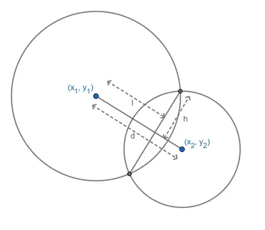

A nice way to look at this is to first consider the case when the center of one circle is at the origin and the center of other lies on the x-axis. Let the centers be at $(0,0)$, $(d,0)$ and the radii be $r_1$, $r_2$. The two equations simplify to $$x^2+y^2=r_1^2$$ and $$(x-d)^2+y^2=r_2^2$$ Use the first to find $y^2$ and substitute in the second. $$(x-d)^2+r_1^2-x^2=r_2^2$$ expand and simplify $$-2xd+d^2+r_1^2=r_2^2$$ so the points of intersections are $(x,y), (x,-y)$ with $$x=\frac{r_1^2-r_2^2+d^2}{2d}$$ and from Pythagorus $$y=\sqrt{r_1^2-x^2}.$$ This part came from mathworld.
For the general position case with centers $(x_1,y_1)$ $(x_2,y_2)$. Let $$\begin{align} d&=\sqrt{(x_1-x_2)^2+(y_1-y_2)^2}\\ l&=\frac{r_1^2-r_2^2+d^2}{2d}\\ h&=\sqrt{r_1^2-l^2} \end{align}$$ General position Now $\left(\tfrac{x_2-x_1}{d},\tfrac{y_2-y_1}{d}\right)$ $\left(\tfrac{y_2-y_1}{d},-\tfrac{x_2-x_1}{d}\right)$ are two orthogonal unit vectors and we can rotate and translate to get the general solution $$\begin{align} x&=\frac{l}{d}(x_2-x_1) \pm \frac{h}{d}(y_2-y_1) + x_1,\\ y&=\frac{l}{d}(y_2-y_1) \mp \frac{h}{d}(x_2-x_1) + y_1.\\ \end{align}$$
    I like this solution a lot, due to its geometric meaning. The interpretation is clear once a diagram is made. I suggest either a diagram or some text such as the following should be included: – TimeVariant Feb 23 '24 at 21:32
    1. Change "... one point is at the origin and the other lies on the x-axis." to "one circle is centered at the origin and the other on the x-axis."
    2. The two points of intersection have the same x-value. [This for the first case.]
    3. Here l and h are the rotated versions of x and y from the special case above.
    – TimeVariant Feb 23 '24 at 21:40
    One thing that caught me out, that I missed initially, is when calculating the x with +, you must calculate the y with -, and visa versa. – Gary van der Merwe Aug 02 '24 at 12:27

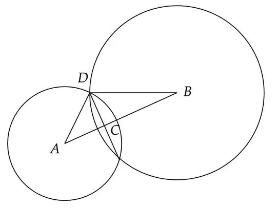

A circle and its two intersections
$A$ and $B$ are the center of the two circles. $C$ is the intersection of the line going through the two circles intersections and the line going through $AB$.
We can solve that problem by normalizing according to length $AB$. It's a funny way to say that we consider that $|AB|=1$.
$\triangle ACD$ is a right triangle, its hypothenuse is $[AD]$.
$\triangle BCD$ is a right triangle, its hypothenuse is $[DB]$.
For convenience, we will write $|AD|$ as $\boxed{r_A}$ as it is the radius of circle $A$.
For convenience, we will write $|DB|$ as $\boxed{r_B}$ as it is the radius of circle $B$.
For convenience, we will write $|AC|$ as $\boxed{x}$ and $|CB|$ a $\boxed{1-x}$ as such that their sum is $1$.
For convenience, we will write $|CD|$ as $\boxed{h}$ as it is the shared height of the two right triangles.
For convenience, we will write $\displaystyle\sqrt{(y_A-y_B)^2+(x_A-x_B)^2}$ as $\boxed{d_{AB}}$
$r_A^2-x^2=r_B^2-(1-x)^2$ because those two right triangles share the same height ($[CD]$).
After simplification, we get: $$x=\frac{r_A^2-r_B^2+1}{2}$$
Reminder: $x$ is how far along $[AB]$ to go in direction $\vec{AB}$ if $|AB|=1$.
We need to know $h$.
It is given by $h=\sqrt{r_A^2-x^2}$ since we are in a right triangle $ACD$.
C is given by
$C=A + (B-A)\cdot x $
We basically translate A over the fractional distance $x$ of $|AB|$.
To find $D$, we will need to normalize $[AB]$, rotate it counter clockwise, stretch it to the length of $h$ and offset it by $C$. This is done with the following:
$D=\frac{(y_A-y_B,x_B-x_A)}{d_{AB}}\cdot h+C$
And to find $E$ (not shown on graphic):
$E=-\frac{(y_A-y_B,x_B-x_A)}{d_{AB}}\cdot h+C$
We can summarize in one ugly formula (of no use):
$D=\frac{(y_A-y_B,x_B-x_A)}{\sqrt{(y_A-y_B)^2+(x_A-x_B)^2}}\cdot \sqrt{r_A^2-\left(\frac{r_A^2-r_B^2+1}{2}\right)^2}+A + (B-A)\cdot \frac{r_A^2-r_B^2+1}{2}$
Here are the maths mathing in Desmos: https://www.desmos.com/calculator/xdgioyukig
