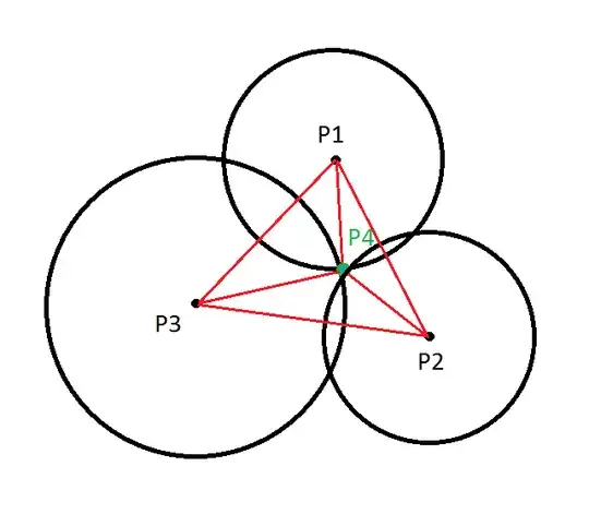

I have a trilateration-related problem that I'm unsure how to solve mathematically. I can see a solution is possible through geometry, but I'm unsure how to solve the resulting equations.
Given three 2D points, find where to put a new point on the same plane. You know the exact distances from the new point to each existing point.
By drawing a picture, it is clear that this is attainable:
In this image, $P_1,P_2,P_3$ are the known points, and $P_4$ is the point we want to find coordinates for. The red lines denote known distances.
Given only two points, we can find 2 candidate positions (where the circles intersect), while the third given point limits us to our solution.
Using the properties of circles, I have come up with 3 equations and 2 unknowns. Let $P_i=[x_i,y_i]^T$ and $r_i=|P_i-P_4|$ for $i\in\{1,2,3,4\}$. Then my set of equations, expanded, is $$r_1^2 = (x_4 - x_1)^2 + (y_4 - y_1)^2\\ r_2^2 = (x_4 - x_2)^2 + (y_4 - y_2)^2\\ r_3^2 = (x_4 - x_3)^2 + (y_4 - y_3)^2$$ How can I calculate $x_4$ and $y_4$?

  • By drawing a picture, it is clear that this is attainable Pictures are not proofs. The $3$ distances are not independent. while the third given point limits us to our solution Solve the first two equations for $x_4, y_4$ first, then use the third equation to eliminate unwanted solutions. – dxiv Oct 01 '16 at 03:52

  • Subtract the second equation the first; also, subtract the third from the first. You obtain two linear equations in $x_4$ and $y_4$. Solve. (Note: Each linear equation corresponds to what's called the "radical axis" of two circles. This axis exists even when the circles don't intersect, but when they do intersect, this axis is the line through the points of intersection.) – Blue Oct 01 '16 at 07:40
    Possible duplicate of Finding location of a point on 2D plane, given the distances to three other know points. Also, duplicate of http://math.stackexchange.com/questions/93586/given-distances-to-3-known-points-2d-find-the-4th-point, and probably a few others. – bubba Oct 01 '16 at 11:00
  • To me, the picture clearly shows that there is no solution, in general. For any given set of data, there is very little chance that the three circles will have any points in common. – bubba Oct 01 '16 at 11:05
  • @bubba:I agree, except if this is a practical problem -- say, some kind of microcontroller project using ultrasonic distance sensors -- when datasets with one point in common are actually the likely ones. Which is why I answered this question (and the way I did). I should have checked for duplicates before answering... – Nominal Animal Oct 01 '16 at 13:43
  • @bubba: The practical purpose of this is to place a figure at a location in a 3D scene. I know that my distances are precise in this case, so I can be sure there is always an answer. – marcman Oct 02 '16 at 02:41
