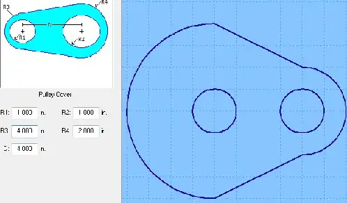

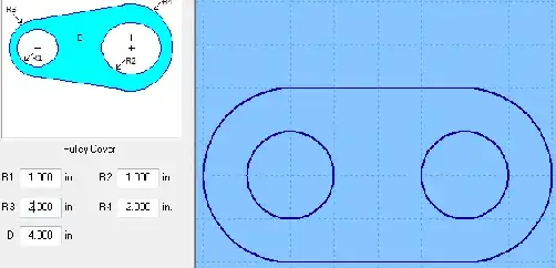

Here is how the code performs for equal sized circles, a line from the top to top makes a nice looking figure.

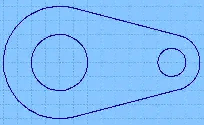

Here is how the code performs for unequal sized circles, a line from the top to top looks a little off enter image description here

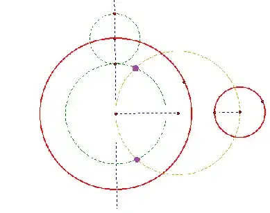

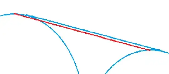

I am trying to determine the tangent points on the circles to draw the lines between. As if you dropped a line onto the circles, I need the points where the line would rest at on each circle. In the picture below, I am drawing the red line currently, but I need the blue one.
From the picture you can see what values I have to work with. How might I go about finding the proper points?

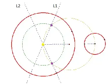

Following the link in the first edit on how to determine the external tangent lines of the circles, the first thing I need to do is determine the two points of intersection of the two temporary circles drawn to help us (The larger green dotted line circle, and the orange dotted line circle)
If the equation for the two circles are $$(x-x_{green})^2 + (y-y_{green})^2 = r_{green}^2, \tag{Green}$$ $$(x-x_{orange})^2 + (y-y_{orange})^2 = r_{orange}^2. \tag{Orange}$$ Then the equation of the line that intersects the two is (As per this math.stack answer.) $$-2x(x_{green}- x_{orange}) - 2y(y_{green} - y_{orange}) = (r_{green}^2 - r_{orange}^2) - (x_{green}^2 - x_{orange}^2) - (y_{green}^2 - y_{orange}^2).$$ The problem is I am not sure how to obtain the two intersection points from this equation.
So I did find these points, lets call the them $$(r_{top}, s_{top}) \tag{Top}$$ $$(r_{bot}, s_{bot}) \tag{Bottom}$$ Given those two points and the center of the large green circle I can find an equation for line 1 and line 2
Respectively the equation of those two lines would be $$(y_{green}-s_{top})=m_{top}(x_{green}-r_{top}) \quad where \quad m_{top}=\frac{(s_{top}-x_{green})}{(r_{top}-y_{green})} \tag{Line 1}$$ $$(y_{green}-s_{bot})=m_{bot}(x_{green}-r_{green}) \quad where \quad m_{bot}=\frac{(s_{bot}-x_{green})}{(r_{bot}-y_{green})} \tag{Line 2}$$
After I have the equation for these two lines I need to find the point on both where they intersect the main circle $r_{large}$ (From the very first picture). Given that the equation for the circle $r_{large}$ is
$$(x-x_{large})^2 + (y-y_{large})^2 = r_{large}^2, \tag{Largest of two main circles}$$
I would need to solve the equation of the two lines each for x or y, lets go with y
$$y_{top}=m_{top}(x_{green}-r_{top})+s_{top}$$ $$y_{bot}=m_{bot}(x_{green}-r_{bot})+s_{bot}$$
Now we can plug those into the equation for the main circle
$$(x-x_{large})^2+(y_{top}-y_{large})^2=r_{large}^2$$ $$(x-x_{large})^2+(y_{bot}-y_{large})^2=r_{large}^2$$
Then we can solve for x
$$x=x_{top} = \sqrt{r_{large}^2-(y_{top}-y_{large})^2}+x_{large}$$ $$x=x_{bot} = \sqrt{r_{large}^2-(y_{bot}-y_{large})^2}+x_{large}$$
Which you give us $(x_{top},y_{top})$ and $(x_{bot},y_{bot})$, these are the top and bottom points on the largest circle that lie on the external tangent lines of the two circles.
Now I thought given these two points the two tangent points for the smaller circle would be easier to find. If using pencil and paper, all you need to do is draw perpendicular lines from the two tangent points. But to get the actual values is more difficult.
Where would I even start to find the other set of tangent points on the small circle?
