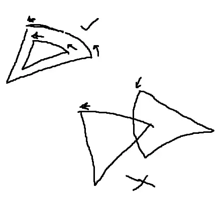

I have two arcs defined with the following information:
Origin, Radius, StartPoint, EndPoint, StartAngle & EndAngle
The angles are signed so you know which direction around the circle the arc goes.
An arc inside an arc segment does not count as an overlap as the perimeters don't touch:
Is it possible to test if the two arcs intersect along their perimeters (I am not looking to test if the area of the circle segments overlap).
My current idea is using an algorithm to interpolate along the arcs as straight line segments and do line-line intersection tests for each line segment - which can be slow depending on how many line segments i use, but I am wondering if there is a more pure mathematical approach ?

  • There is the minor issue that such information for a single arc does not in itself distinguish between a short arc and a long arc. Are you supposed to take the short arc or the anti-clockwise arc or something else? – Henry Jun 16 '21 at 00:09
  • Find the intersections between the two circles and check if any of them falls within the arcs. – dxiv Jun 16 '21 at 00:11
  • Oh, my bad, let me rephrase it the arcs are defined with a start point and end point so i'll reword it. – WDUK Jun 16 '21 at 00:11
  • @dxiv an arc can fall inside another arc but not intersect at perimeter so it being within an arc doesn't mean it intersects. – WDUK Jun 16 '21 at 00:12
    @WDUK Not sure what you mean. Any intersection between the arcs is an intersection between the circles that the arcs belong to. There can only be 0, 1 or 2 such intersections (or infinitely many if the circles coincide). So you can determine those intersections, then check if any of them fall within the arcs. – dxiv Jun 16 '21 at 00:16
  • @dxiv I can test the circles overlap easily but not sure how to then check if just the arc's perimeters overlap each other. Its finding the intersection points that i don't know how to calculate at least mathematically. – WDUK Jun 16 '21 at 00:20
