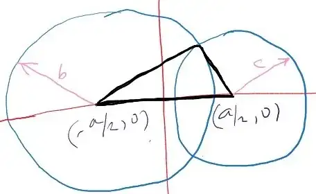

I would do the following. Let the lengths be $a, b, c$
  1. Take the first length $a$. Make the first point $(-\frac{a}{2}, 0)$, and the second point $(\frac{a}{2}, 0)$.
  2. Draw a circle of radius $b$ centered at $(-\frac{a}{2}, 0)$, and another circle of radius $c$ centered at $(\frac{a}{2}, 0)$.
  3. Use the steps delineated here to find the points of intersection of the two circles. Both points are possibilities for the third point.
In order to reduce clutter, let $a=|BC|$, $b=|AC|$ and $c=|AB|$. W.l.o.g. place $A$ at the origin and $B$ at $(c,0)$. The $x$-coordinate of $C$ is then $x_C = b\cos\angle{BAC}$. From the referenced formulas (which are just an application of the Law of Cosines) we have $$\cos\angle{BAC} = {b^2+c^2-a^2 \over 2bc},$$ and by the Pythagorean theorem the $y$-coordinate of $C$ is $y_C = \pm\sqrt{b^2-x_C^2}$.

  • This was exactly what I was looking for. It seems like $y^2_{C}$ should be $y_{C}$ instead. Probably just a typo. – paaskus Oct 20 '17 at 00:27
  • Yeah, it’s a typo. I had originally written something more complex and neglected to remove the exponent when I simplified it. – amd Oct 20 '17 at 00:57
