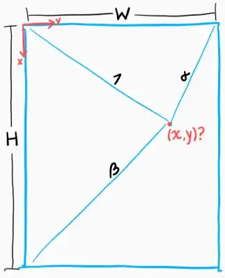

I think the picture can explain it better than words, but I'm wondering how to figure this out. Given three ratios of distances from corners, not lengths (in the picture I set the base, $base=1$, to be the distance from the top left corner, while the other two corners are of lengths $\alpha\cdot$$base$ and $\beta\cdot$$base$) and given the height $H$ and width $W$ of a rectangle, what are the coordinates of a point with said ratios? I'm sure the Apollonian Theorem comes into play, but I can't quite figure it out. Thanks!
Segment $1$ and segment $\alpha$ create a circle of possibilities called the Circle of Apollonius, with endpoints of its diameter at $\frac{W}{1+\alpha}$ and $\frac{W}{1-\alpha}$. $\beta$ and $H$ work similarly. You can then intersect these circles to find two solutions.
