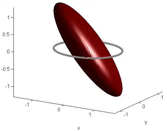

First of all, a graphical illustration (Matlab program given below). enter image description here

Matlab program for the "cigar and smoke ring" figure:
clear all;close all;hold on;axis equal;
p=0.05;
[X, Y, Z] = meshgrid(-1:p:1, -1:p:1, -1.5:p:1.5);
r=1;a=3;b=1;c=2;d=2;e=1;f=2;
A=[a b d
   b c e
   d e f];% caution: the coefficients' order has been changed
isosurface(X, Y, Z, a*X.^2 + 2*b*X.*Y + c*Y.^2 +...
  f*Z.^2 + 2*d*X.*Z+ 2*e*Y.*Z, r^2);
camlight(60,0);shading flat;view([30,15]);
S=A(1:2,1:2)-(1/f)*A(1:2,3)*A(3,1:2);%Schur complement
u=S(1,1);v=S(2,2);w=S(2,1);
ff = @(x,y) (u*x.^2 + v*y.^2 + 2*w*x.*y-1);% please note the -1
ep=ezplot(ff);set(ep,'linecolor',[0.5,0.5,0.5],'linewidth',3);
