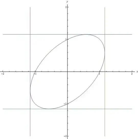

In the $xy$-plane, the equation simplifies to $x^2+y^2-xy-1=0$. Implicitly differentiating with respect to $x$ gives us
$$2x+2y\frac{dy}{dx} - y - x\frac{dy}{dx} = 0 \implies \frac{dy}{dx} = \frac{y-2x}{2y-x}.$$
Now, you get horizontal tangent lines when the numerator is zero (i.e. when $dy/dx = 0$), which implies that $y-2x=0\implies y=2x$. Substituting this back into the implicit equation gives us $$x^2+4x^2-2x^2 -1 = 0 \implies 3x^2=1 \implies x=\pm \frac{\sqrt{3}}{3}$$
and thus $y = \pm\dfrac{2\sqrt{3}}{3}$ are the equations of the horizontal tangent lines.
Similarly, we find the vertical tangent lines when the denominator is zero (i.e. when $dy/dx$ is undefined), which implies that $2y-x=0\implies x=2y$. In a similar fashion, we get that $y=\pm\dfrac{\sqrt{3}}{3}$ and hence $x=\pm\dfrac{2\sqrt{3}}{3}$ are the equations of the vertical tangent lines.

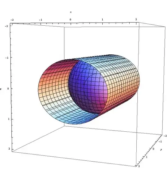

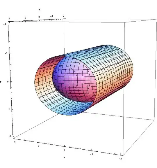

Now why did we go through all of this? Well, the equations of the tangent lines tells us how far along the $x$ and $y$ axis the ellipse extends; in particular, the vertical tangents give us a bound on $x$ and $y$ for the ellipse (i.e. $-2\sqrt{3}/3 \leq x,y \leq 2\sqrt{3}/3$). These bounds play the role of the major axes for the $xz$ and $yz$ projections of the ellipsoid onto the $y=0$ and $x=0$ planes respectively. The minor axis will be along the $z$ direction; in particular, along the ellipsoid, $-1\leq z\leq 1$. With that said, the corresponding projection of the ellipsoid onto the $yz$-plane is $$\frac{3y^2}{4} + z^2 = 1$$
and the corresponding projection onto the $xz$-plane is $$\frac{3x^2}{4} + z^2 = 1$$
Note that the last two figures are cylinders of the projections as seen in three space; the purpose of visualizing them this way was to show you that they completely enclose the ellipsoid of interest.
