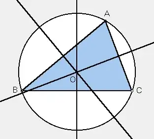

Because the chords given by the edges of a triangle in the circumscribed circle all belong to the same circle, the perpendicular bisector of those chords must go through the center of that circle, and hence all three lines will intersect in the center.

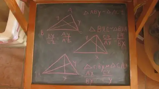

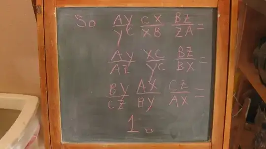

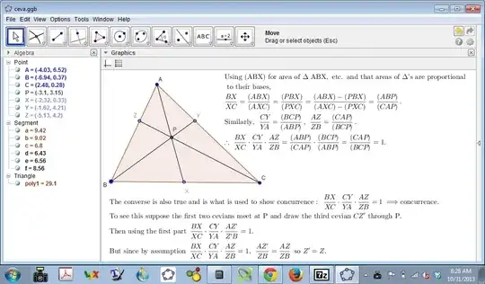

The 3 cevian concurrences can all be proved using Ceva's theorem, shown in the diagram below, although, for internal bisectors, a proof using Ceva's theorem would be more complicated (outline of easier way is: since any point on any bisector is equidistant from the adjacent sides, and since any two bisectors share one adjacent side, the point where they intersect is equidistant from all three sides). Below the diagram for Ceva's theorem is a diagram outlining how you could use Ceva's to show concurrence of altitudes.
I think the 'single explanation' though would be interesting. Does anyone know a way to explain the idea of ALL triangle concurrences based on something intrinsic about triangles?
Ceva's Theorem
Ceva's Theorem applied to altitudes

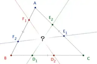

Extended Ceva's Theorem. Consider points $D_1$, $D_2$, $E_1$, $E_2$, $F_1$, $F_2$ on the (extended) edges of $\triangle ABC$, with $D_i$, $E_i$, $F_i$ on the (extended) edge opposite vertex $A$, $B$, $C$, respectively.
Extended Ceva' Theorem
Lines $\overleftrightarrow{D_1E_2}$, $\overleftrightarrow{E_1F_2}$, $\overleftrightarrow{F_1D_2}$ concur if and only if $$\begin{align} 1 &= \frac{|BD_1|}{|D_1C|} \frac{|CE_1|}{|E_1A|} \frac{|AF_1|}{|F_1B|} + \frac{|D_2C|}{|BD_2|} \frac{|E_2A|}{|CE_2|} \frac{|F_2B|}{|AF_2|} \\[6pt] &+ \frac{|BD_1|}{|D_1C|} \frac{|D_2C|}{|BD_2|} + \frac{|CE_1|}{|E_1A|} \frac{|E_2A|}{|CE_2|} + \frac{|AF_1|}{|F_1B|} \frac{|F_2B|}{|AF_2|} \qquad\qquad (\star\star\star\star) \end{align}$$ Note: The above uses signed lengths, with $\overrightarrow{AB}$, $\overrightarrow{BC}$, $\overrightarrow{CA}$ indicating the direction of a positively-signed segment on each of the triangle's sides.
We get Ceva's Theorem back from the Extended Ceva's Theorem by moving $D_2$, $E_2$, $F_2$ to coincide with $C$, $A$, $B$, respectively, so that $|D_2C| = |E_2A| = |F_2B| = 0$; this eliminates all but the first term of the right-hand side of $(\star\star\star\star)$.
For the perpendicular variant, with the three lines ("orthians"?) perpendicular to the sides of $\triangle ABC$ at $D_1$, $E_1$, $F_1$, we can write $$|D_2C| = |BC| - |BD_2| \qquad |E_2A| = |CA| - |CE_2| \qquad |F_2B| = |AB| - |AF_2|$$ and then also $$|BD_2| = -\frac{|F_1B|}{\cos B} \qquad |CE_2| = -\frac{|D_1C|}{\cos C}\qquad |AF_2| = -\frac{|E_1A|}{\cos A}$$ (the negatives maintain the relationships of the signed lengths). Expressing the cosines in terms of the lengths of the triangles edges, and then expressing those lengths as $$|BC| = |BD_1|+|D_1C| \qquad |CA| = |CE_1| + |E_1C| \qquad |AB| = |AF_1|+|F_1B|$$ equation $(\star\star\star\star)$ eventually reduces to something much nicer than $(\star\star\star)$; namely, $$|BD_1|^2 + |CE_1|^2 + |AF_1|^2 = |D_1C|^2 + |E_1A|^2 + |F_1B|^2$$ (In a recent answer, I call the above result "Ortha's Theorem" and provide a stand-alone geometric proof.)
