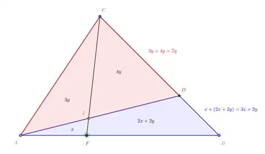

Let us look at the image below first
We know $AF:FB = 1:2$ ,this implies $[FIA]=x \implies [FBI]=2x$. Similarly $[DIB]=2y \implies [CID] = 4y$
Because $[CAF]:[CFB]=1:2$ and $[CFB]=6y+2x$, then $[CAF]=3y+x$ and $[CIA]=3y$.
We know the ratio $AF:AB = 1:3$, so ratio $[CAF]:[CFB]=1:2$.
Why at some point we can conclude that each of the three cevians $AD, EB, CF$, are divided by the ratio $1:3:3$?

You have stated in the question that $[CIA]=3y$. Thus, using this and $[CID] = 4y$ gives that $AI:ID = 3:4$. Similarly, $BG:GE = CH:HF = 3:4$.
Also, $[CAD] = [CIA] + [CID] = 3y + 4y = 7y$. In addition, using your diagram's area values, $[BAD] = x + 2x + 2y = 3x + 2y$. Since $[CAD]:[BAD] = 2:1$, we get
$$\frac{7y}{3x + 2y} = \frac{2}{1} \; \; \to \; \; 7y = 6x + 4y \; \; \to \; \; y = 2x \tag{1}\label{eq1}$$
Using $[FIA] = x$ and $[CIA]=3y$ (that you've determined) gives that $FI:IC = x:3y = x:6x = 1:6$. Also, I earlier showed $CH:HF = 3:4$, so since $1 + 6 = 3 + 4$, the base values used in both ratios are the same, and thus $FI:IH:HC = 1:3:3$.
It can be similarly proven (left to the reader) that the other $2$ cevians are divided by the same ratios.

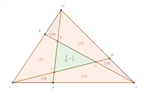

We may and do assume that the area $[ABC]$ is one.
Following the arguments of the OP, we already have the following information regarding the areas cut / separated from $[ABC]$ by two cevians, $AF$ and $BD$:
Areas delimited from a triangle by two trisectors
In particular we have $2:1=CD:DB=\color{red}{7y}:\color{blue}{3x+2y}$, which implies $7y=2(3x+2y)$, i.e. $y=2x$. Then we can immediately express the piece $x$ in terms of the total area $$ 1=[ABC]=\color{red}{7y}+\color{blue}{3x+2y}=14x+3x+4x=21x \ , $$ so $x=[AIF]=1/21$, and $y=2/21$. By the same argument, and/or by cylcic shift in the notation, we have $$ [AIF]=[BGD]=[CHE]=\frac 1{21}\ . $$ We also have so far $3y=[AIC]=6/21$. We remove the area of the triangle $\Delta CHE$ from this quantity, thus getting by symmetry the following quadrilateral areas: $$ [AIHE]=[BGIF]=[CHGD]=\frac6{21}-\frac 1{21}=\frac 5{21}\ . $$ For the triangle in the middle, the remained area is $$ [GHI]=\frac{21-1-1-1-5-5-5}{21}=\frac 3{21}=\frac 17\ . $$ In a picture:
Area of triangle delimited by three trisectors
Note: The above computed the area of the "inner" triangle $\Delta GHI$ without knowing the proportion $AI:IG:GD$. A posteriori, if we really need it, we can for instance compute $AI:ID=[CAI]:[CID]=3y:4y=3:4$, $AG:GD=[AGC]:[GDC]=6:1$.
Note: In such cases much of the effort is reduced by using directly the Theorem of Menelaus. For instance, applying it for $\Delta ABD$ with the line intersecting the sides in $F,C,I$, we can write immediately: $$ \frac{FA}{FB}\cdot\frac{CB}{CD}\cdot\frac{ID}{IA}=1\ . $$ So $AI:ID=3:4$.
dan_fulea

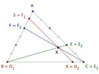

Here's an approach using the Extended Ceva's Theorem that I presented in an earlier answer way back in 2013.
Extended Ceva's Theorem. Consider points $D_1$, $D_2$, $E_1$, $E_2$, $F_1$, $F_2$ on the (extended) edges of $\triangle ABC$, with $D_i$, $E_i$, $F_i$ on the (extended) edge opposite vertex $A$, $B$, $C$, respectively.
Extended Ceva' Theorem
Lines $\overleftrightarrow{D_1E_2}$, $\overleftrightarrow{E_1F_2}$, $\overleftrightarrow{F_1D_2}$ concur if and only if $$\begin{align} 1 &= \frac{|BD_1|}{|D_1C|} \frac{|CE_1|}{|E_1A|} \frac{|AF_1|}{|F_1B|} + \frac{|D_2C|}{|BD_2|} \frac{|E_2A|}{|CE_2|} \frac{|F_2B|}{|AF_2|} \\[6pt] &+ \frac{|BD_1|}{|D_1C|} \frac{|D_2C|}{|BD_2|} + \frac{|CE_1|}{|E_1A|} \frac{|E_2A|}{|CE_2|} + \frac{|AF_1|}{|F_1B|} \frac{|F_2B|}{|AF_2|} \qquad\qquad \tag{$\star$} \end{align}$$
Note: The above uses signed lengths, with $\overrightarrow{AB}$, $\overrightarrow{BC}$, $\overrightarrow{CA}$ indicating the direction of a positively-signed segment on each of the triangle's sides.
For the problem at hand, I'll use two of the given trisecting cevians at a time, along with a line through their intersection, parallel to a side of the triangle.
First, we consider trisecting cevians $\overline{BE}$ and $\overline{CF}$ with intersection $X$, with $\overline{PQ}$ through $X$, parallel to $\overline{AB}$. To match the elements of $(\star)$, we make the following assignments:
$$D_1 = P \qquad D_2 = C \qquad E_1 = E \qquad E_2 = Q \qquad F_1 = F \qquad F_2 = B \tag{1}$$
Then $(\star)$ becomes
$$\begin{align} 1 &= \frac{|BP|}{|PC|} \frac{|CE|}{|EA|} \frac{|AF|}{|FB|} + \frac{|CC|}{|BC|} \frac{|QA|}{|CQ|} \frac{|BB|}{|AB|} + \frac{|BP|}{|PC|} \frac{|CC|}{|BC|} + \frac{|CE|}{|EA|} \frac{|QA|}{|CQ|} + \frac{|AF|}{|FB|} \frac{|BB|}{|AB|} \tag{2} \\[6pt] &= \frac{|BP|}{|PC|}\cdot \frac12\cdot \frac12 + 0 + 0 + \frac12 \cdot \frac{|QA|}{|CQ|} + 0 \tag{3} \end{align}$$
Now, defining $$\lambda := \frac{|CX|}{|XF|} = \frac{|CP|}{|PB|} = \frac{|CQ|}{|QA|} \tag{4}$$ we have $$1 = \frac1{\lambda} \cdot \frac14 + \frac12 \cdot \frac1{\lambda} \quad\to\quad \lambda = \frac34 \tag{5}$$
On the other hand, we can take $\overline{RS}$ through $X$, parallel to $\overline{AC}$. We make new assignments with respect to $(\star)$:
$$D_1 = B \qquad D_2 = R \qquad E_1 = C \qquad E_2 = E \qquad F_1 = S \qquad F_2 = F \tag{6}$$
This time, $(\star)$ becomes
$$\begin{align} 1 &= \frac{|BB|}{|BC|} \frac{|CC|}{|CA|} \frac{|AS|}{|SB|} + \frac{|RC|}{|BR|} \frac{|EA|}{|CE|} \frac{|FB|}{|AF|} + \frac{|BB|}{|BC|} \frac{|RC|}{|BR|} + \frac{|CC|}{|CA|} \frac{|EA|}{|CE|} + \frac{|AS|}{|SB|} \frac{|FB|}{|AF|} \tag{7} \\[6pt] &= 0 + \frac{|RC|}{|BR|} \cdot 2 \cdot 2 + 0 + 0 + \frac{|AS|}{|SB|} \cdot 2 \tag{8} \end{align}$$
Defining $$\mu := \frac{|BX|}{|XE|} = \frac{|BR|}{|RC|} = \frac{|BS|}{|SA|} \tag{9}$$ we have ... $$ 1 = \frac1{\mu} \cdot 4 + \frac1{\mu} \cdot 2 \qquad\to\qquad \mu = 6 \tag{10}$$
The result follows from $(5)$ and $(10)$, as well as the symmetry in how the ratios apply across all of the cevians. $\square$
