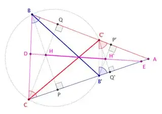

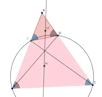

The orthocenter of $\triangle ABC$ is $H$. Let $B'$ be a point on AC and $C'$ be a point on AB, such that $BCB'C'$ is a cyclic quadrilateral. Let the orthocenter of $\triangle AB'C'$ be $H'$.
Prove that the lines $BB', CC'$and $HH'$ are concurrent.
I am quite lost on how to solve the question. I know that $\triangle AB'C'$ is similar to $\triangle ABC$, but how may I use this to advantage? Can anyone help? :)

Here's an approach using multiple applications of an Extended Ceva's Theorem that I introduced in a previous answer. The theorem gives a condition for concurrence of (almost) any three lines passing through the edges of a triangle, not just those through vertices.
Extended Ceva's Theorem. Consider points $D_1$, $D_2$, $E_1$, $E_2$, $F_1$, $F_2$ on the (extended) edges of $\triangle ABC$, with each $D_i$, $E_i$, $F_i$ on the (extended) edge opposite vertex $A$, $B$, $C$, respectively.
Lines $\overleftrightarrow{D_1E_2}$, $\overleftrightarrow{E_1F_2}$, $\overleftrightarrow{F_1D_2}$ concur if and only if $$\begin{align} 1 &= \frac{|BD_1|}{|D_1C|} \frac{|CE_1|}{|E_1A|} \frac{|AF_1|}{|F_1B|} + \frac{|D_2C|}{|BD_2|} \frac{|E_2A|}{|CE_2|} \frac{|F_2B|}{|AF_2|} \\[6pt] &+ \frac{|BD_1|}{|D_1C|} \frac{|D_2C|}{|BD_2|} + \frac{|CE_1|}{|E_1A|} \frac{|E_2A|}{|CE_2|} + \frac{|AF_1|}{|F_1B|} \frac{|F_2B|}{|AF_2|} \qquad (\star) \end{align}$$
In the current scenario, we could take our lines to be $\overleftrightarrow{BB^\prime}$, $\overleftrightarrow{CC^\prime}$, and $\overleftrightarrow{HH^\prime}$. The last of these we would need to extend to give points, say $D$ on $\overleftrightarrow{BC}$ and $E$ on $\overleftrightarrow{CA}$.
The corresponding concurrence condition arises from the substitutions $$F_2 \to B, \quad E_1 \to B^\prime, \quad D_2 \to C, \quad F_1 \to C^\prime, \quad D_1 \to D, \quad E_2 \to E$$ which reduce $(\star)$ to $$\begin{align} 1 &= \frac{|CB^\prime|}{|B^\prime A|}\;\left(\; \frac{|BD|}{|DC|} \frac{|AC^\prime|}{|C^\prime B|} + \frac{|EA|}{|CE|}\;\right) \qquad (1) \end{align}$$
As OP notes, $\triangle AB^\prime C^\prime \sim \triangle ACB$, say with proportionality factor $k$. This makes computing two of the ratios easy:
$$\frac{|CB^\prime|}{|B^\prime A|} = \frac{b - k c }{k c} \qquad\qquad \frac{|AC^\prime|}{|C^\prime B|} = \frac{k b}{c-k b}$$
The remaining two ratios, which we'll name $$ m := \frac{|BD|}{|DC|} \qquad\qquad n := \frac{|EA|}{|CE|}$$ are a little trickier to deduce. One can use coordinates, but for less effort than it takes to determine points $D$ and $E$ from $\overleftrightarrow{HH^\prime}$ and calculate the ratios, you could just verify that the intersection of $\overleftrightarrow{BB^\prime}$ and $\overleftrightarrow{CC^\prime}$ lies on $\overleftrightarrow{HH^\prime}$. There may also be a clever geometric argument leveraging various similar triangles, but I want to try something different.
Instead, we'll take advantage of the fact that each of $H$ and $H^\prime$ is a point of concurrence of $\overleftrightarrow{HH^\prime}$ with two other lines. This gives us two instances of $(\star)$ involving $m$ and $n$, so that we can solve for these values.
First, $H$ is where $\overleftrightarrow{HH^\prime}$ meets $\overleftrightarrow{BP}$ and $\overleftrightarrow{CQ}$. The Extended Ceva's Theorem with the substitutions $$F_2 \to B, \quad E_1 \to P, \quad D_2 \to C, \quad F_1 \to Q, \quad D_1 \to D, \quad E_2 \to E$$ gives $$1 = \frac{|CP|}{|PA|}\;\left(\; m \; \frac{|AQ|}{|QB|} + n\;\right)$$ so that $$1 = \frac{a\cos C}{c\cos A}\;\left(\; m \; \frac{b \cos A}{a \cos B} + n\;\right) = m \; \frac{b \cos C}{c\cos B} + n\;\frac{a \cos C}{c \cos A} \qquad(2)$$
On the other hand, $H^\prime$ is the point where $\overleftrightarrow{HH^\prime}$ meets $\overleftrightarrow{B^\prime P^\prime}$ and $\overleftrightarrow{C^\prime Q^\prime}$. Unfortunately, we can't just make substitutions into $(\star)$ using $B^\prime$, $C^\prime$, $P^\prime$, $Q^\prime$, $D$, $E$, since these points aren't in the appropriate configuration on the edges of $\triangle ABC$. To remedy this, take $X = \overleftrightarrow{BC}\cap\overleftrightarrow{B^\prime P^\prime}$ ; then we can make these substitutions: $$D_2 \to X, \quad F_1 \to P^\prime, \quad F_2 \to C^\prime, \quad E_1 \to Q^\prime, \quad D_1 \to D, \quad E_2 \to E$$ to get $$\begin{align} 1 &= m\; \frac{|CQ^\prime|}{|Q^\prime A|} \frac{|AP^\prime|}{|P^\prime B|} + n \; \frac{|XC|}{|BX|} \frac{|C^\prime B|}{|AC^\prime|} \\[6pt] &+ m\; \frac{|XC|}{|BX|} + n \; \frac{|CQ^\prime|}{|Q^\prime A|} + \frac{|AP^\prime|}{|P^\prime B|} \frac{|C^\prime B|}{|AC^\prime|} \end{align}$$ so that $$\begin{align} 1 &= m\; \frac{b-kb\cos A}{k b \cos A} \frac{k c \cos A}{c - k c \cos A} - n \; \frac{(c-kc\cos A)/\cos B - a}{(c-kc\cos A)/\cos B} \frac{c - k b}{k b} \\[6pt] &- m\; \frac{(c-kc\cos A)/\cos B - a}{(c-kc\cos A)/\cos B} + n \; \frac{b - k b \cos A}{k b \cos A} + \frac{k c \cos A}{c - k c \cos A} \frac{c - k b}{k b} \end{align}$$
(Note the sign change with the $|XC|/|BX|$ terms, since $\overrightarrow{XC}$ and $\overrightarrow{BX}$ point in opposite directions.) This becomes
$$ k c \cos A \cos C = m\;k b \cos A\cos B + n \; ( c \sin A \sin B - k \cos A ( c \cos C + b \cos B )) \quad (3)$$
Solving $(2)$ and $(3)$ for $m$ and $n$ gives $$ m = \frac{(c - k b ) \cos B}{(b - k c ) \cos C} \qquad\qquad n = \frac{k (b^2-c^2) \cos A}{a ( b - k c )\cos C} $$ and one can verify that these satisfy $(1)$, proving the concurrence of $\overleftrightarrow{BB^\prime}$, $\overleftrightarrow{CC^\prime}$, $\overleftrightarrow{HH^\prime}$. $\square$
Admittedly, the algebraic details got a bit hairier than I intended when I embarked on this journey. (The reader is invited to derive $m$ and $n$ via clever geometry, so as to use $(1)$ more-directly.) Nevertheless, I think this makes for a not-unreasonable application of the Extended Ceva Theorem.

Here is a complete proof along the lines of my comments to the OP. Most of it is well-known stuff, but it probably doesn't hurt to build it from scratch.
First of all, the problem follows from the following claim:
Theorem 1. Let $A$, $B$, $C$ and $D$ be four points on a circle. Let $X=AB\cap CD$ and $Y=BC\cap DA$. (I use the notation $\ell\cap m$ to denote the point of intersection of two lines $\ell$ and $m$, even though it would be more formally correct to say that $\ell\cap m$ is a one-element set consisting of this point. I also pretend that everything is in general position when needed, as usually done in this kind of geometry.) Then, the orthocenters of the triangles $XBC$, $XDA$, $YAB$ and $YCD$ lie on one line, and the point $AC\cap BD$ also lies on this line.
To recover the original problem from this theorem, we need to apply it to $C$, $B^{\prime}$, $C^{\prime}$, $B$ and $A$ instead of $A$, $B$, $C$, $D$ and $X$.

It is not so difficult to prove such concurrency with trilinear coordinates.
Let $A=[1,0,0],B=[0,1,0],C=[0,0,1],H=\left[\frac{1}{\cos A},\frac{1}{\cos B}.\frac{1}{\cos C}\right]$.
In order to have $BCB'C'$ cyclic, we must have $\frac{AC'}{AB'}=\frac{AC}{AB}$, so: $$ B'=[b-\lambda c,0,\lambda a],\qquad C'=[c-\lambda b,\lambda a,0],$$ and the coordinates of the lines $BB',CC'$ in the dual space are: $$ BB'^*=[\lambda a,0,\lambda c-b],\quad CC'^*=[\lambda a,\lambda b-c,0],$$ and: $$ X = BB'\cap CC' = \left[1,\frac{\lambda a}{c-\lambda b},\frac{\lambda a}{b-\lambda c}\right].$$ So, we have just to compute the trilinear coordinates of $H'$ and check that $X\in HH'.$
We have $d\left(H',AB\right)=\frac{1}{\lambda}d(H,AC), d\left(H',AC\right)=\frac{1}{\lambda}d(H,AB)$, so: $$ H'=\left[\cdot,\frac{1}{\lambda\cos C},\frac{1}{\lambda\cos B}\right]=\left[\star,\cos B,\cos C\right],$$ giving that the circumcenter of $ABC$ belongs to the $AH'$ line. At last, we have just to compute $d(H',BC)$ in order to find $\star$ and check that $X\in HH'$. This is left to the reader since it is not so interesting, I think that the interesting part of this answer is the shown technique.
