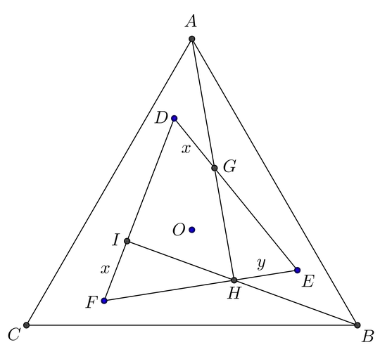

  1. Equilateral triangles $ABC$ and $DEF$ are concentric. Points $A,G$ and $H$ are collinear. Points $B,H$ and $I$ are collinear. Let $DG=FI=x$ and $EH=y$. Prove that $x=y$.

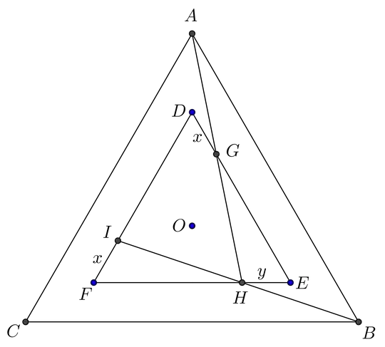

  1. Now suppose the internal triangle $DEF$ is rotated about its centre by some small angle so that points $A$ and $G$ are still on opposite sides of line $DF$. Prove that the result is still true.
I have an algebraic solution to the first problem above. But I'm trying to find a clean geometric proof. I've made no progress on the second generalisation of the first result. I've tried all the usual tricks (congruence, rule of sines and cosines etc.) but to no avail. Does anyone have any approach to such problems that might work?

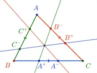

My tool of choice is my Extended Ceva's Theorem, introduced in this answer, but reformulated here:
Extended Ceva's Theorem. Lines $\overleftrightarrow{A^+B^{-}}$, $\overleftrightarrow{B^+C^-}$, $\overleftrightarrow{C^+A^-}$ through the edges of $\triangle ABC$ concur if and only if $$\alpha^+ \beta^+ \gamma^+ + \alpha^-\beta^-\gamma^- + \alpha^+\alpha^- + \beta^+\beta^- +\gamma^+\gamma^- = 1 \tag{$\star$}$$
where $$\alpha^+ := \frac{|BA^+|}{|A^+ C|} \qquad \beta^+ := \frac{|CB^+|}{|B^+A|} \qquad \gamma^+ := \frac{|AC^+|}{|C^+B|}$$ $$\alpha^- := \frac{|CA^-|}{|A^- B|} \qquad \beta^- := \frac{|AB^-|}{|B^-C|} \qquad \gamma^- := \frac{|BC^-|}{|C^-A|}$$

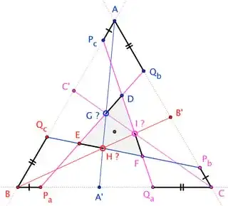

Extend the edges of $\triangle DEF$ to meet the sides of $\triangle ABC$ at points $P_i$ and $Q_i$; by symmetry, there are $p$ and $q$ such that $$ \frac{|BP_a|}{|P_aC|} = \frac{|CP_b|}{|P_bA|} = \frac{|AP_c|}{|P_cB|} = p \qquad \frac{|CQ_a|}{|Q_aB|} = \frac{|AQ_b|}{|Q_bC|} = \frac{|BQ_c|}{|Q_cA|} = q $$
Moreover, extend $\overline{AG}$, $\overline{BH}$, $\overline{CI}$ to meet the edges of $\triangle ABC$ at $A^\prime$, $B^\prime$, $C^\prime$, and define $$\alpha := \frac{|CA^\prime|}{|A^\prime B|} \qquad \beta := \frac{|AB^\prime|}{|B^\prime C|} \qquad \gamma := \frac{|BC^\prime|}{|C^\prime A|}$$
By the ECT with substitutions
$$A^+ \to P_a \qquad A^-\to A^\prime \qquad B^+\to C \qquad B^-\to Q_b \qquad C^+\to A \qquad C^-\to C^\prime$$ so that $$\alpha^+ = p \qquad \beta^+ = \gamma^+ = 0 \qquad \alpha^- = \alpha \qquad \beta^- = q \qquad \gamma^- = \gamma$$ we have that $\overleftrightarrow{CI}$ contains $G$ (which is to say that $\overleftrightarrow{AG}$, $\overleftrightarrow{CI}$, $\overleftrightarrow{DE}$ concur at $G$) if and only if $$1 = \alpha\;(\; p + q \gamma \;) \tag{$1$}$$
Likewise, $\overleftrightarrow{AG}$ contains $H$ if and only if $$1 = \beta\;(\; p + q \alpha \;) \tag{$2$}$$ and $\overleftrightarrow{BH}$ contains $I$ if and only if $$1 = \gamma\;(\;p + q \beta \;) \tag{$3$}$$
Now, the problem asserts that $\overleftrightarrow{AG}$ and $\overleftrightarrow{BH}$ contain $H$ and $I$, respectively; therefore, $(2)$ and $(3)$ hold. The problem also asserts that $\overline{DG}\cong\overline{FI}$, so that $\overline{AC^\prime}\cong\overline{CB^\prime}$, which implies $\alpha = \gamma$. Provided that $p\neq 0$, we may conclude that $\alpha = \beta = \gamma$, that all three concurrencies hold, and that $\overline{DG}\cong\overline{EH}\cong\overline{FI}$.

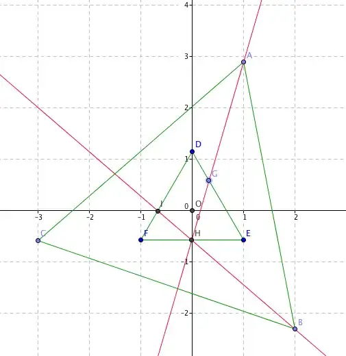

The generalized property is false (unfortunately). Here is a counterexample with simple coordinates :
$$ \begin{array}{llllll} A & (1,\frac{5}{\sqrt{3}}) & B & (2,-\frac{4}{\sqrt{3}}) & C & (-3,-\frac{1}{\sqrt{3}}) \\ D & (0,\frac{2}{\sqrt{3}}) & E & (1,-\frac{1}{\sqrt{3}}) & F & (-1,-\frac{1}{\sqrt{3}}) \\ G & (\frac{1}{3},\frac{1}{\sqrt{3}}) & H & (0,-\frac{1}{\sqrt{3}}) & I & (-\frac{2}{\sqrt{3}},0) \\ \end{array} $$
It is straightforward to check that with those values, $ABC$ and $DEF$ are both equilateral and centered at the origin, that $H$ is the middel of $[EF]$ and that
$$ \overrightarrow{HA}=3\overrightarrow{HG}, \overrightarrow{DE}=3\overrightarrow{DG}, \overrightarrow{BI}=\frac{4}{3}\overrightarrow{BH}, \overrightarrow{FD}=3\overrightarrow{FI}. $$
Here is the corresponding figure :enter image description here
Ewan Delanoy
  • 63,436
  • I forgot to mention a key assumption. Sorry, that is completely my fault, and I thank you for your efforts. Points $A$ and $G$ are on opposite sides of line $DF$. I've amended the question to reflect this. Sorry again! – Auslander Feb 26 '15 at 20:17
  • @David I just noticed that $D$ is the middle of $[AF]$ in my example – Ewan Delanoy Feb 26 '15 at 21:09
  • Right. What does this mean about the truth of my conjecture? Are you suggesting that it's still false unless I add further restrictions? – Auslander Feb 26 '15 at 21:19
  • I just did a little simulation of my own and it appears that if $A$ is anywhere on line $DF$, then if you change the position of $G$, $DG$ is always equal to $FI$. Otherwise the conjecture still looks true... – Auslander Feb 26 '15 at 22:19
