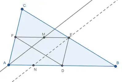

Here is a more elementary proof simply using, i) the midpoint theorem, ii) alternate interior angles theorem which states that if two parallel lines are cut by a traversal, the alternate interior angles are congruent, and iii) Concurrency of angle bisectors theorem.
$D, E$ and $F$ are midpoints of the sides of $\triangle ABC$. Line through $AM$ is the angle bisector of $\angle A$. Line through $EN$ is parallel to $AM$ and through midpoint $E$ of side $BC$.
Using midpoint theorem, $ADEF$ is a parallelogram and $\angle DEF = \angle A$.
Using property of parallel lines, $\angle FEN = \angle FMA = \angle MAD = \frac{\angle A}{2}$. So line through $EN$ is angle bisector of $\angle DEF$ in $\triangle DEF$. By the same logic, parallel lines through midpoints to other two angle bisectors of $\triangle ABC$ must be angle bisectors of $\angle DFE$ and $\angle EDF$.
Hence the proof is complete by concurrency of angle bisectors of a triangle.

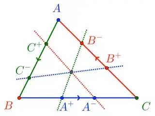

I'll exploit a result that I presented in this answer, with different notation:
Extended Ceva's Theorem. Defining ratios of signed lengths, $$\alpha^+ := \frac{|BA^+|}{|A^+C|} \qquad \beta^+ :=\frac{|CB^+|}{|B^+A|} \qquad \gamma^+ := \frac{|AC^+|}{|C^+B|}$$ $$\alpha^- := \frac{|CA^-|}{|A^-B|} \qquad \beta^- :=\frac{|AB^-|}{|B^-C|} \qquad \gamma^- := \frac{|BC^-|}{|C^-A|}$$ the lines $\overleftrightarrow{A^+B^-}$, $\overleftrightarrow{B^+C^-}$, $\overleftrightarrow{C^+A^-}$ concur iff $$\alpha^+\beta^+\gamma^+ + \alpha^-\beta^-\gamma^- + \alpha^+\alpha^- + \beta^+\beta^- + \gamma^+\gamma^- \;=\; 1\tag{$\star$} $$
If $A^+$, $B^+$, $C^+$ are midpoints, then $\alpha^+=\beta^+=\gamma^+=1$, and $(\star)$ reduces to $$\alpha^-\beta^-\gamma^- + \alpha^-+\beta^-+\gamma^- = 0$$ However, we'll find that the angle bisector context makes it natural to express the "$-$" ratios in terms of the "$+$" ones; so I won't invoke the midpoint property prematurely.

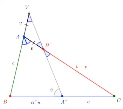

Focusing on the angle bisector from $A$ aspect, let $\overleftrightarrow{A^+B^-}$ be parallel to that bisector, and let it meet the extended side $\overline{AB}$ at $V$.
With $u$, $v$, $\theta$ as labeled in the figure, we can use the Law of Sines on $\triangle BA^+V$ and $\triangle CA^+B^-$ to write $$\frac{\alpha^+ u}{c+v} = \frac{\sin\frac12A}{\sin\theta} = \frac{u}{b-v} \quad\to\quad v = \frac{\alpha^+b-c}{\alpha^++1} \quad\to\quad \beta^-:=\frac{v}{b-v}=\frac{\alpha^+ b-c}{b+c}$$ Likewise, $$\gamma^-=\frac{\beta^+ c-a}{c+a} \qquad \alpha^-=\frac{\gamma^+ a-b}{a+b}$$
Substituting into $(\star)$, we can write $$\frac{(1 + \alpha^+)(1 - \beta^+ \gamma^+)}{a} + \frac{(1 + \beta^+ )(1 - \gamma^+\alpha^+)}{b} + \frac{(1 + \gamma^+)(1 - \alpha^+\beta^+ )}{c} = 0\tag{$\star\star$}$$ This general condition for concurrence of bisector-parallels through $A^+$, $B^+$, $C^+$ is clearly satisfied when $\alpha^+=\beta^+=\gamma^+=1$ (ie, when $A^+$, $B^+$, $C^+$ are midpoints). $\square$
