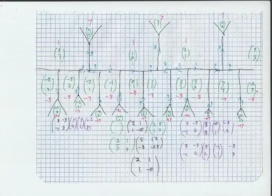

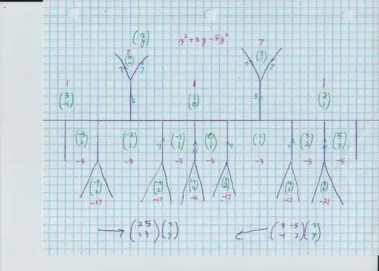

This sort of thing has a clear description in terms of Conway's topograph; I find it more convenient to use equivalent form $u^2 + uv - 5 v^2.$ The outcome for the original problem is sequences (note that the rule deals with every other element). For instance, $5\cdot 9 - 2 = 43$ and $5 \cdot 14 -3 = 67$
$$ x_{n+4}= 5 x_{n+2} - x_n,$$ $$ y_{n+4}= 5 y_{n+2} - y_n,$$
There are two interleaved subsequences.
$$ \begin{array}{c} 1&1&2&3&9&14&43&67&206&321&987 &1538&4729& \ldots \\ 3&2&1&1&2&3&9&14&43&67&206&321&987&\ldots \\ \end{array} $$ Running the indices backwards leads to different solutions, but they are just transpositions of the ones above.
Let's see, given $u^2 + uv - 5 v^2 = -5$ and $x=u+3v, y=v$ gives $x^2 - 5 xy + y^2 = -5$ and the reverse holds as well
enter image description here Apparently I drew one of these in 2016 enter image description here

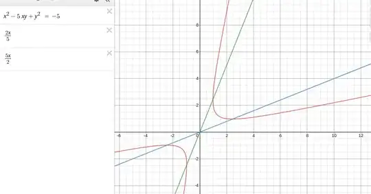

A "fundamental" solution is one that minimizes $x+y$ as much as possible. That is, fundamental when both $$ x+y \leq 5y - x + y $$ and $$ x+y \leq x +5x - y . $$ The first one becomes $$ 2x \leq 5 y, $$ the second $$ 2y \leq 5x .$$
Altogether, fundamental solutions are on the arc $x^2 - 5xy + y^2 $ with $$\frac{2x}{5} \leq y \leq \frac{5x}{2} $$
As you can see, there are the two integer points between the slanted lines, those being $(2,1)$ and $(1,2).$ Every solution in positive integers reduces to one of these; in turn, jumping up from one of the fundamental solutions generates all solutions.
