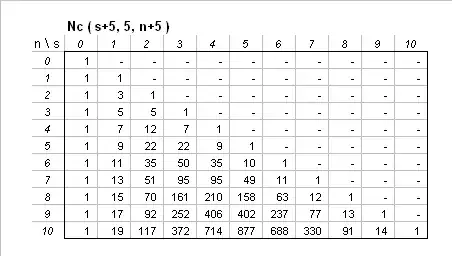

Note the coefficients of the series correspond with the table entries stated by @GCab.
Looking for instance at the blue marked coefficient $12$ of $s^7f^2z^9$ this gives the number of words of length $9$ containing $7$ S at least one run of $5$ S and ending with S. These words are \begin{align*} \color{blue}{SSSSS}SFFS&\qquad SSFF\color{blue}{SSSSS}\\ \color{blue}{SSSSS}FSFS&\qquad SFSF\color{blue}{SSSSS}\\ \color{blue}{SSSSS}FFSS&\qquad SFFS\color{blue}{SSSSS}\\ SF\color{blue}{SSSSS}FS&\qquad FSSF\color{blue}{SSSSS}\\ FS\color{blue}{SSSSS}FS&\qquad FSFS\color{blue}{SSSSS}\\ F\color{blue}{SSSSS}FSS&\qquad FFSS\color{blue}{SSSSS} \end{align*} where the right-most run of $5$ S is marked blue.

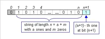

Consider the strings composed as shown in the sketch in para. c) above.
Their total number is $\binom {s+m}{s} = \binom {n}{s}$ and each has the same probability $p^{s+1}\, q^m = p^{s+1}\, q^{n-s}$.

  • @GCab: I see, the table entries correspond with the series expansion in my answer. Good work. (+1) – Markus Scheuer Sep 05 '20 at 22:35
