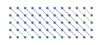

Hint:
Unless you define the coefficients with an out-of-range index to be zero, you cannot express the product with a straight nested sum.
As the figure shows, the groups of coefficients for the terms with constant exponent form two triangular and one parallelogrammic patterns.
You will need a sum with a linearly increasing number of terms, one with a constant number, and one with a decreasing number. You can also arrange sums where the delimiting indexes are made of $\min/\max$ expressions.
