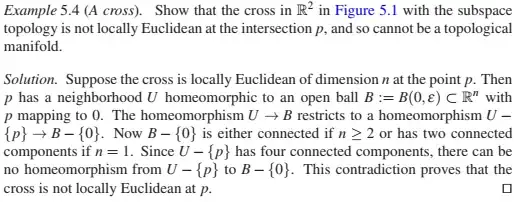

Example
Firstly, to show the cross is not locally Euclidean

Next, what is the proof exactly? Here is my attempt.
Let $n \in \mathbb N$. Choose $p$ to be the intersection. Let $U$ be any neighborhood of $p$ in $M$.
For some reason, $V$ is an open ball namely $V=B(0,\varepsilon)$.
Let $\varphi: U \to V$ be a map. For some reason $\varphi(p)=0$. If $\varphi$ were a homeomorphism, then $\varphi_R: U \setminus p \to B(0,\varepsilon) \setminus 0$ is a homeomorphism too, but this is a contradiction because of the facts about components.

The definition of locally Euclidean is fine.
Suppose a point $p\in M$ has an open neighbourhood $U$ such that there exists an open set $V\subseteq\Bbb R^n$ and a homeomorphism $\varphi:U\to V$. You may not necessarily have that
  1. $V$ is an open ball centred at origin,i.e. $V=B(0,\varepsilon)$
  2. $\varphi(p)$ is the origin, i.e. $\varphi(p)=0$,
but you can construct a new function from $\varphi$ satisfying the above two properties.
First, given a fixed vector $v\in\Bbb R^n$, the map $\Bbb R^n\to\Bbb R^n, x\mapsto x+v$ is a homeomorphism (and, it still is a homeomorphism upon restricting the domain and codomain properly). In particular, choose $v=-\varphi(p)$ and the map $V\to V-\varphi(p), x\mapsto x-\varphi(p)$, is a homeomorphism. The map $f:U\to V-\varphi(p), f(x):=\varphi(x)-\varphi(p)$, is a homeomorphism from an open neighbourhood of $p$ to an open set of $\Bbb R^n$, with the property that $p$ is sent to the origin $0$.
Second, restrict the domain and codomain of $f$ properly. The codomain is restricted to an open ball $B(0,\varepsilon)$ while the domain is restricted to its preimage $f^{-1}(B(0,\varepsilon))$. The map $f:f^{-1}(B(0,\varepsilon))\to B(0,\varepsilon)$ is a homeomorphism between the two sets. What you may want to prove is that $f^{-1}(B(0,\varepsilon))$ is an open neighbourhood of $p$.
So, my comment to your attempt, is that you don't need to prove case 2 at all, if you have proved for case 1 already.
