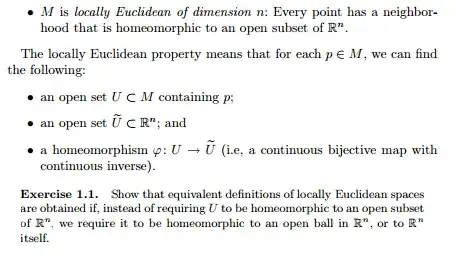

I am working on Exercise 1.1 and I think the way to do this would be to show that open sets are homeomorphic to $\mathbb{R}^n$ or open balls in $\mathbb{R}^n$. Is this even true? I'm not sure how to go about proving it.
BTW: The exercise is from Lee's Introduction to Smooth Manifolds.

    Here's a hint: An open set $U$ in $\mathbb R^n$ has the property that for any $p\in U$, there is a neighborhood of $p$ contained in $U$ which is homeomorphic to $\mathbb R^n$ (a ball suffices). – Milo Brandt Mar 31 '15 at 03:13
  • Not all open subsets of $\mathbb{R}^n$ are homeomorphic to $\mathbb{R}^n$. For example, $(0, 1)\cup(2, 3)$ is open in $\mathbb{R}$ but it certainly isn't homeomorphic to $\mathbb{R}$ as it is not connected. – Michael Albanese Mar 31 '15 at 03:13
    To answer your question in a nutshell. Yes, open balls are homeomorphic to $\mathbb R^n$. First show $(0,1)$ is homeomorophic to $\mathbb R$ and you'll see why. – Gregory Grant Mar 31 '15 at 03:16

Open balls in $\Bbb R^n$ are homeomorphic to $\Bbb R^n$, but it’s not true in general that (non-empty) open sets in $\Bbb R^n$ are homeomorphic to $\Bbb R^n$: $\Bbb R^n$ and its open balls are connected, but there are lots of open sets in $\Bbb R^n$ that are not connected. However, if $U$ is an open nbhd of $x$ in $\Bbb R^n$, then there is an open ball $B$ such that $x\in B\subseteq U$, so if every point $M$ has a nbhd homeomorphic to some open $U\subseteq\Bbb R^n$, then it automatically has one homeomorphic to an open ball in $\Bbb R^n$. The other direction is trivial, since every open ball in $\Bbb R^n$ is an open set in $\Bbb R^n$.
Finally, to prove that an open ball in $\Bbb R^n$ is homeomorphic to $\Bbb R^n$ itself, it suffices to prove it for the open unit ball centred at the origin. Consider the map from the open unit ball to $\Bbb R^n$ that sends $x$ to $\left(\tan\frac{\pi|x|}2\right)x$.

  • Okay thanks! So it seems my idea does not work. How would I go about solving the exercise then? – iYOA Mar 31 '15 at 04:49
    @iYOA: You're welcome! That's what I was getting at with the However sentence: the moment you have a nbhd $N$ of $x$ that's homeomorphic to some open $U\subseteq\Bbb R^n$ by a homeomorphism $h$, find an open ball $B$ such that $h(x)\in B\subseteq U$, and look at $h^{-1}[B]$: it's a nbhd of $x$ homeomorphic to an open ball. – Brian M. Scott Mar 31 '15 at 05:22
  • ohh okay I see now. – iYOA Apr 01 '15 at 00:18
