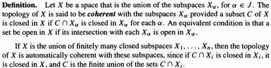

Munkres Topology. In Section 71, coherent is "if" but on Wikipedia (Coherent topology), it's "if and only if"

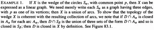

This can be seen in Example 1 of Section 83
We suppose $D \cap A_{\alpha}$ is closed in $A_{\alpha}$ and then must show $D$ is closed in $X$. I don't think we also suppose $D$ is closed in $X$ and then show that the $D \cap A_{\alpha}$'s are closed.

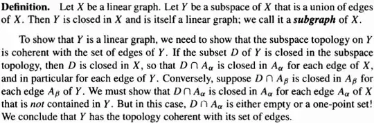

But in the definition of subgraph (also in Section 83), coherent is "if and only if" (I am aware of the errata by Barbara and Jim Munkres for this definition but irrelevant I think).
I was expecting to see that we suppose $D \cap A_{\beta}$ is closed in $A_{\beta}$ and then must show $D$ is closed in $Y$, but we actually also show We suppose $D$ is closed in $X$ and then show that the $D \cap A_{\alpha}$'s are closed.

The notion Munkres gives is the right one in that context. $X$ already has a topology and its subspaces $X_\alpha$ have the subspace topology induced by it, so we already know by definition that $O$ open in $X$ implies $O \cap X_\alpha$ open in $X_\alpha$.
The coherence part comes from the idea that we suppose we are just given the subspace topologies on $X_\alpha$ at the start (and we "forget" the topology on $X$) can we then reconstruct the topology on $X$ from these? In a coherent topology you can: you test for a subset $O$ of $X$ whether indeed each set $O \cap X_\alpha$ is open in the subspace topology in $X_\alpha$, and if this is the case we conclude $O$ must have open in $X$, and we get exactly the original topology on $X$ back.
Because this is the new part in coherence Munkres only states the implication of the second paragraph. The standard pasting lemma's say that any open cover of $X$ or any (locally) finite closed cover of $X$ form a coherent family for $X$.
