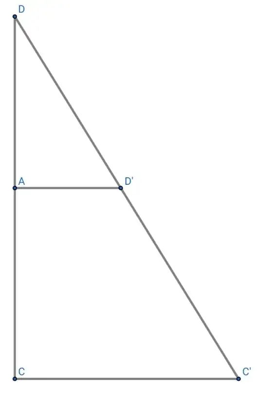

Let initially dog be at $D$ and cat at $C$ and after time $dt$ they are at $D'$ and $C'$ respectively. Dog velocity is always pointing towards cat.
Let $DA = dy, \;AD' = dx$
Let $CC'=udt,\;DD' = vdt$ as interval is very small so $DD'$ can be taken straight line.
Also we have $\frac{DA}{DC}= \frac{AD'}{ CC'}$ using triangle property.
$\frac{dy}{L}= \frac{dx}{udt}\\ dx = \frac{dy.udt}{L}$
$\sqrt{(dx)^2 + (dy)^2} = DD' = vdt \\ \sqrt{(\frac{dy.udt}{L})^2 + (dy)^2} = vdt $
Here $t$ varies from $0-T$, and $y$ varies from $0-L$. Now how to proceed?enter image description here

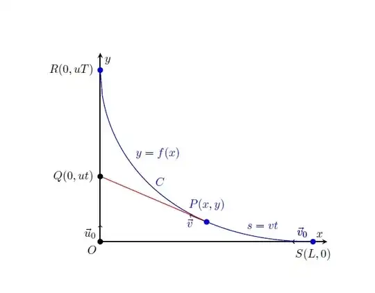

I assume that: (a) the dog starts at the point $S=(L,0)$ and the cat at the origin $O=(0,0)$; (b) the cat moves in the positive direction along the $y$-axis, and the dog describes a curve of pursuit (WolframMathWorld link) $C$ in the $xy$-plane. I call $y=f(x)$ the equation of $C$.
  1. At time $t$ the tangent line to $C$ at the point $P(x,y)$ passes through the point $Q=(0,ut)$, which means that the derivative $y^{\prime }=f^{\prime}(x)=dy/dx$ is $$ y^{\prime }=\frac{y-ut}{x}.\tag{A} $$ Solving for $t$ we get
    $$ t=\frac{y-xy^{\prime }}{u}.\tag{A'} $$
  2. Let $s$ be the distance traveled by the dog from $S$ to $P$, i.e. the length of the arc $SP$ measured along $C$. Since the arc length formula is the integral $$ s=\int_{x}^{L}\sqrt{1+\left( f^{\prime }(\xi )\right) ^{2}}d\xi =-\int_{L}^{x}\sqrt{1+\left( f^{\prime }(\xi )\right) ^{2}}d\xi , \tag{B}$$ and $s=vt$, we have $$ t=\frac{s}{v}=-\frac{1}{v}\int_{L}^{x}\sqrt{1+\left( f^{\prime }(\xi )\right) ^{2}}d\xi =\frac{y-xy^{\prime }}{u}.\tag{B'} $$ Hence, equating $(A')$ to $(B')$, we get $$ -\frac{u}{v}\int_{L}^{x}\sqrt{1+\left( f^{\prime }(\xi )\right) ^{2}}d\xi =y-xy^{\prime }\tag{C} $$
  3. Differentiate both sides and simplify $$\begin{eqnarray*} -\frac{u}{v}\sqrt{1+\left( y^{\prime }\right) ^{2}} &=&\frac{d}{dx}\left( y-xy^{\prime }\right) \\ -\frac{u}{v}\sqrt{1+\left( y^{\prime }\right) ^{2}} &=&y^{\prime }-\left( y^{\prime }+xy^{\prime \prime }\right) =-xy^{\prime \prime }. \end{eqnarray*}$$ to get the following differential equation $$ \sqrt{1+\left( y^{\prime }\right) ^{2}}=kxy^{\prime \prime },\qquad k=\frac{v}{u}>1.\tag{D} $$
  4. Set $w=y^{\prime }$ and solve $(D)$ for $w$ applying the method of separation of variables. Then $$ \sqrt{1+w^{2}}=kxw^{\prime }=kx\frac{dw}{dx}\Leftrightarrow \frac{dw}{\sqrt{ 1+w^{2}}}=\frac{dx}{kx}.\tag{E} $$ So $$\begin{eqnarray*} \int \frac{dw}{\sqrt{1+w^{2}}} &=&\int \frac{dx}{kx}+C \\ \text{arcsinh }w &=&\frac{1}{k}\ln x+\ln C_{1}.\tag{F} \end{eqnarray*}$$ The initial condition $x=L,w=y^{\prime }(L)=0$ determines the constant $C_{1}$ $$ 0=\frac{1}{k}\ln L+\ln C_{1}\Rightarrow C_{1}=e^{-\frac{1}{k}\ln L}. $$ Consequently, $$ \text{arcsinh }w=\frac{1}{k}\ln x-\frac{1}{k}\ln L=\frac{1}{k}\ln \frac{x}{L}.\tag{G} $$ Solve $(G)$ for $w$ and rewrite in terms of exponentials using the definition of $\sinh z=\frac{1}{2}\left( e^{z}-e^{-z}\right) $ $$ \frac{dy}{dx}=w=\sinh \left( \frac{1}{k}\ln \frac{x}{L}\right) =\frac{1}{2}\left( \left( \frac{x}{L}\right) ^{1/k}-\left( \frac{x}{L}\right) ^{-1/k}\right)\tag{H} $$ This last differential equation is easily integrable $$\begin{eqnarray*} y &=&\frac{1}{2}\int \left( \frac{x}{L}\right) ^{1/k}-\left( \frac{x}{L} \right) ^{-1/k}dx \\ &=&\frac{1}{2}\left( \frac{L}{1/k+1}\left( \frac{x}{L}\right) ^{1/k +1}-\frac{L}{1-1/k}\left( \frac{x}{L}\right) ^{1-1/k}\right) +C \end{eqnarray*}\tag{I}$$ Find $C$ making use of the initial condition $x=L,y=0$ $$\begin{eqnarray*} 0 &=&\frac{1}{2}\left( \frac{L}{1/k+1}\left( \frac{L}{L}\right) ^{1/k+1}-\frac{L}{1-1/k}\left( \frac{L}{L}\right) ^{1-1/k}\right) +C \\ &\Rightarrow &C=\frac{Lk}{k^{2}-1}. \end{eqnarray*}$$ The equation of the trajectory is thus $$ y=\dfrac{L}{2}\left( \dfrac{1}{\dfrac{1}{k}+1}\left( \dfrac{x}{L}\right) ^{\dfrac{1}{k}+1}-\dfrac{1}{1-\dfrac{1}{k}}\left( \dfrac{x}{L}\right) ^{1-\dfrac{1}{k}}\right) +\dfrac{Lk}{k^{2}-1}.\tag{J} $$
  5. To obtain the time $T$ the dog takes to catch the cat, make $x=0$ in the last equation and observe that the cat travels the distance $y=f(0)=uT$ (point $(R)$):
    $$ y=f(0)=\frac{Lk}{k^{2}-1}=\frac{Lv/u}{\left( v/u\right) ^{2}-1}=\frac{uv}{v^{2}-u^{2}}L=uT.\tag{K} $$ Therefore $$ T=L\frac{v}{v^{2}-u^{2}}.\tag{L} $$

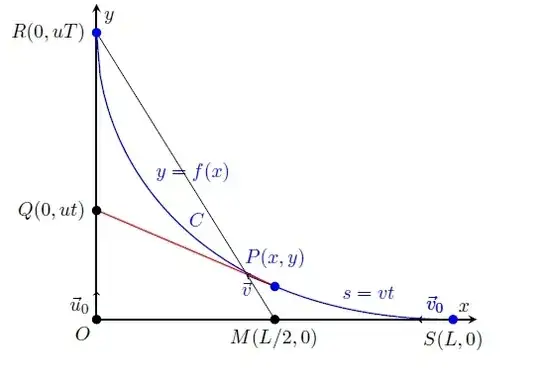

ADDED. Let $M$ be the point $(L/2,0)$. We can easily verify that the total length of $C$ is equal to $\overline{SM}+\overline{MR}$.
Suppose the cat is running along the $y$ axis. If $\rho$ is the distance between the dog and the cat, $\rho_y$ is the distance between them along the $y$ axis and $\alpha = \alpha(t)$ is the angle between the trajectories, then $$\frac {d\rho} {dt} = u \cos \alpha - v, \\ \frac {d\rho_y} {dt} = u - v \cos \alpha, \\ \frac d {dt} (v \rho + u \rho_y) = u^2 - v^2, \\ v \rho + u \rho_y = (u^2 - v^2) t + v L = 0, \\ t = \frac {v L} {v^2 - u^2}.$$
