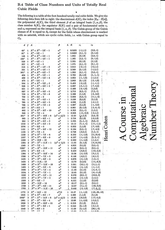

Found a table in Cohen, his "d" tends to equal $p^2,$ where mine is sometimes $4p^2$
