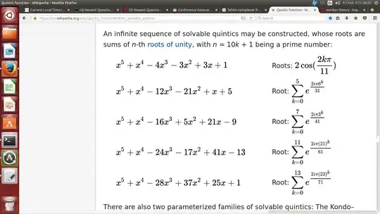

ORIGINAL QUESTION: I should emphasize that I am interested in quintics with five real irrational roots, Galois group cyclic $\mathbb Z_5,$ such that the roots can be expressed as sums of roots of unity (in conjugate pairs), therefore as sums of cosines of rational multiples of $\pi.$
The wording at the wikipedia section on solvable cyclic quintics suggests that there is an infinite sequence of such examples as they display. However, they give no source for this sub-section. As you will see below, i had no trouble extending their recipe for primes $101$ and $131,$ but the items i found for prime $151$ have the wrong Galois groups. I have jumped to prime $181$ and bigger $p = 10 n + 1,$ we will see what happens. I have stuck with their recipe...note that, by a strict integer translation, it is reasonable to also consider $x^5 + 2 x^4 + more,$ or $x^5 + 3 x^4 + more,$ or $x^5 + 4 x^4 + more.$ There is plenty of literature on $x^5 + e x^3 + stuff.$ Oh, with $p = 10 n + 1$ prime, our polynomial is $$ x^5 + x^4 - 4 n x^3 + a x^2 + b x + c $$ i have been assuming that we want the discriminant to be a square, in particular $w^2 p^4,$ where $w$ is not divisible by $p.$
The questions are: where did wikipedia find this material, also are there more.
https://en.wikipedia.org/wiki/Quintic_function#Other_solvable_quintics

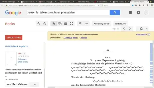

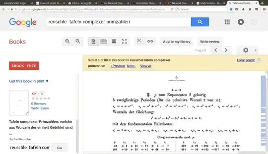

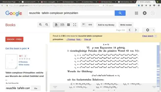

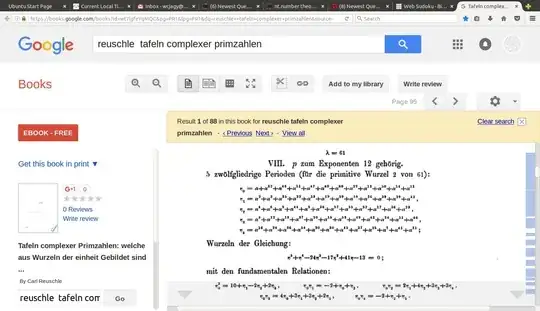

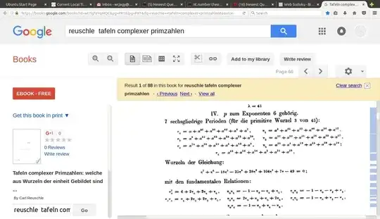

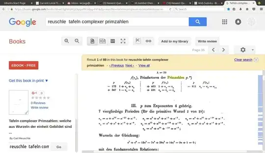

enter image description here enter image description here enter image description here enter image description here enter image description here

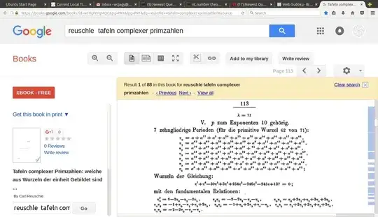

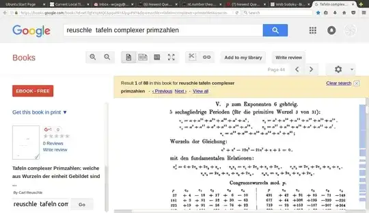

  • @Hurkyl thanks. I have found these in an 1875 book, Reuschle does everything for primes up to 100, then prime powers up to 100; anyway https://books.google.com/books?id=wt7lgfeYqMQC&pg=PR1&lpg=PR1&dq=reuschle++tafeln+complexer+primzahlen&source=bl&ots=VGZFPrfUBn&sig=MlQ667PqXaQ9rAvLWkG3_F1rwsk&hl=en&sa=X&ved=0ahUKEwiIwtSvm9TQAhUJ-2MKHXJIA_kQ6AEIODAE#v=onepage&q=reuschle%20%20tafeln%20complexer%20primzahlen&f=false – Will Jagy Dec 04 '16 at 21:07

The first three below are in Reuschle pages 35, 66, 113.
$$ x^7 + x^6 - 12 x^5 - 7 x^4 + 28 x^3 + 14 x^2 - 9 x + 1, \; \; p = 29, \; \; r = 2, \; \; 12^k $$ $$ x^7 + x^6 - 18 x^5 - 35 x^4 + 38 x^3 + 104 x^2 + 7 x - 49, \; \; p = 43, \; \; r = 3, \; \; 7^k $$ $$ x^7 + x^6 - 30 x^5 + 3 x^4 + 254 x^3 - 246 x^2 - 245 x + 137, \; \; p = 71, \; \; r = 7, \; \; 14^k $$ $$ x^7 + x^6 - 48 x^5 + 37 x^4 + 312 x^3 - 12 x^2 - 49 x - 1, \; \; p = 113, \; \; r = 3, \; \; 35^k $$
$$ x^7 + x^6 - 54 x^5 - 31 x^4 + 558 x^3 - 32 x^2 - 1713 x + 1121, \; \; p = 127, \; \; r = 3, \; \; 24^k $$ $$ x^7 + x^6 - 84 x^5 - 217 x^4 + 1348 x^3 + 3988 x^2 - 1433 x - 1163, \; \; p = 197, \; \; r = 2, \; \; 20^k $$ $$ x^7 + x^6 - 90 x^5 + 69 x^4 + 1306 x^3 + 124 x^2 - 5249 x - 4663, \; \; p = 211, \; \; r = 2, \; \; 10^k $$ $$ x^7 + x^6 - 102 x^5 - 195 x^4 + 1850 x^3 + 978 x^2 - 8933 x + 5183, \; \; p = 239, \; \; r = 7, \; \; 23^k $$ $$ x^7 + x^6 - 120 x^5 - 711 x^4 - 784 x^3 + 1956 x^2 + 2863 x - 343, \; \; p = 281, \; \; r = 3, \; \; 61^k $$ $$ x^7 + x^6 - 144 x^5 + 399 x^4 + 2416 x^3 - 10808 x^2 + 10831 x - 1237, \; \; p = 337, \; \; r = 10, \; \; 38^k $$ $$ x^7 + x^6 -162 x^5 -201 x^4 + 7822 x^3 + 12322 x^2 -107717 x -193369, \; \; p= 379, \; \; 11^k $$
$$ x^7 + x^6 -180 x^5 -103 x^4 + 6180 x^3 + 11596 x^2 -25209 x -49213, \; \; p= 421, \; \; 34^k $$ $$ x^7 + x^6 -192 x^5 + 275 x^4 + 3952 x^3 + 4136 x^2 -81 x -863, \; \; p= 449, \; \; 24^k $$ $$ x^7 + x^6 -198 x^5 -907 x^4 + 4302 x^3 + 20582 x^2 -18973 x -56911, \; \; p= 463, \; \; 6^k $$ $$ x^7 + x^6 -210 x^5 + 1423 x^4 -1410 x^3 -8538 x^2 + 9203 x + 19427, \; \; p =491, \; \; 63^k $$ $$ x^7 + x^6 -234 x^5 + 335 x^4 + 13254 x^3 -42874 x^2 -55309 x + 71879, \; \; p=547, \; \; 26^k $$
